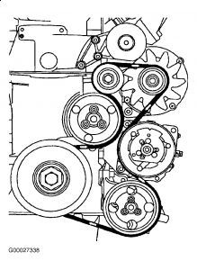

Need diagram for replacing a serpentine belt
2001 VOLKSWAGEN JETTA
DUBERRIE
Six cylinder front wheel drive automatic 115,000 miles.
My serpentine belt broke yesterday. I have purchased a new belt but need a diagram or explanation of how it is installed. The car is a VR6, 2.0L with air conditioning. Any help would be much appreciated!

the VR6 is a 2.8L, not 2.0L and diagram is below of serpentine belt for the VR6.
https://images.2carpros.com/forum/automotive_pictures/261618_Graphic_391.jpg
