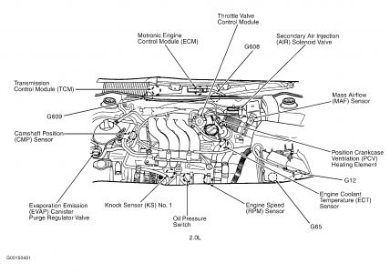

The car has the 2.0 engine. Where is the sensor on this vehicle? Thank you, Jeff

On the cylinder head behind the camshaft sprocket
https://images.2carpros.com/forum/automotive_pictures/1639_vw_2.jpg
