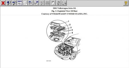

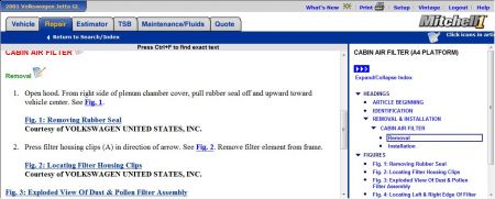

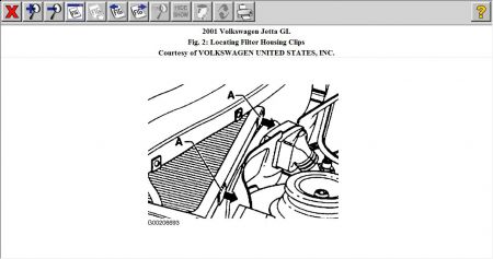

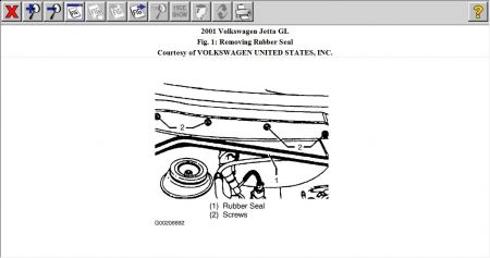

Greetings,
I have been unable to locate the cabin air filter. The owners manual does not speak of it and I cannot find it under the hood near or in the cowl nor underneath the dash. Can you tell me where to find the "hidden" compartment?

Here you go- Good Luck
https://images.2carpros.com/forum/automotive_pictures/12900_cf1_14.jpg
https://images.2carpros.com/forum/automotive_pictures/12900_cf2_14.jpg
https://images.2carpros.com/forum/automotive_pictures/12900_cf3_5.jpg
https://images.2carpros.com/forum/automotive_pictures/12900_cf4_2.jpg
