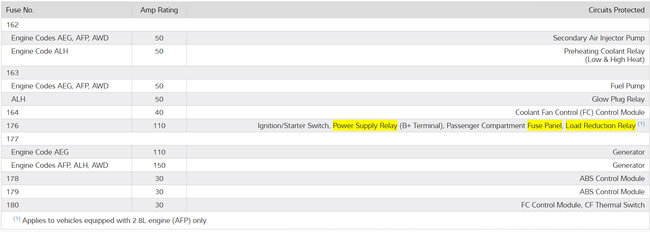

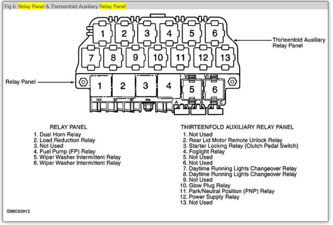

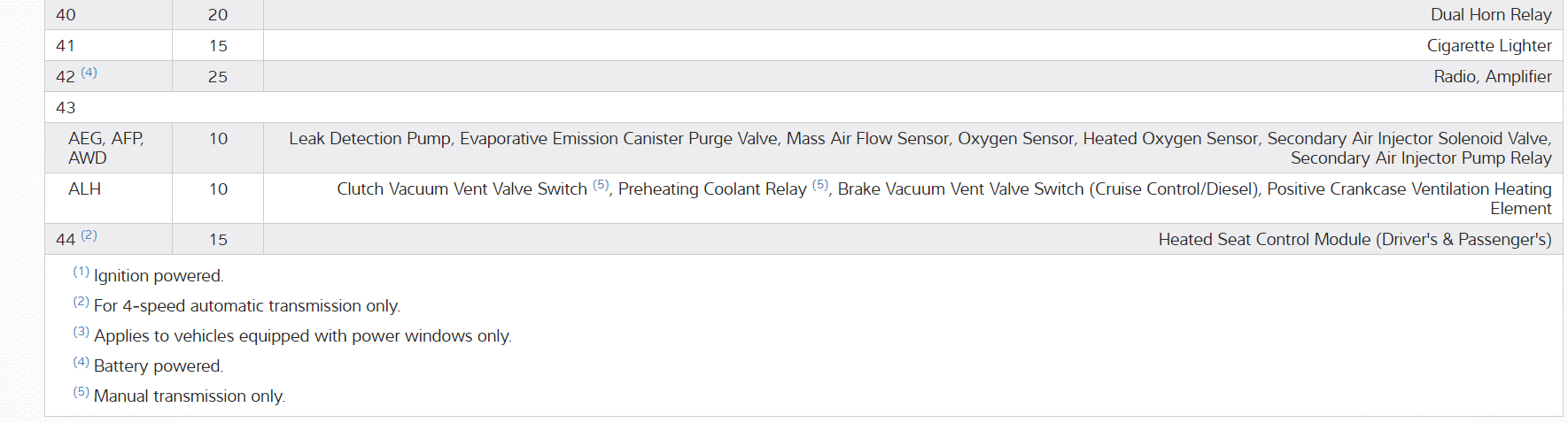

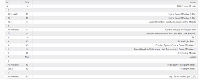

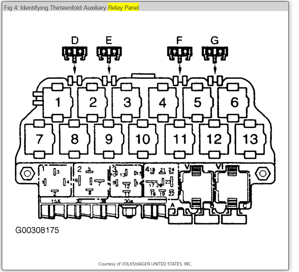

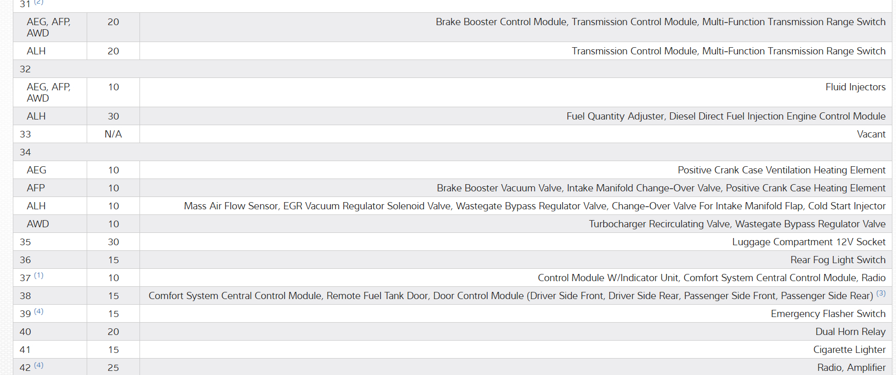

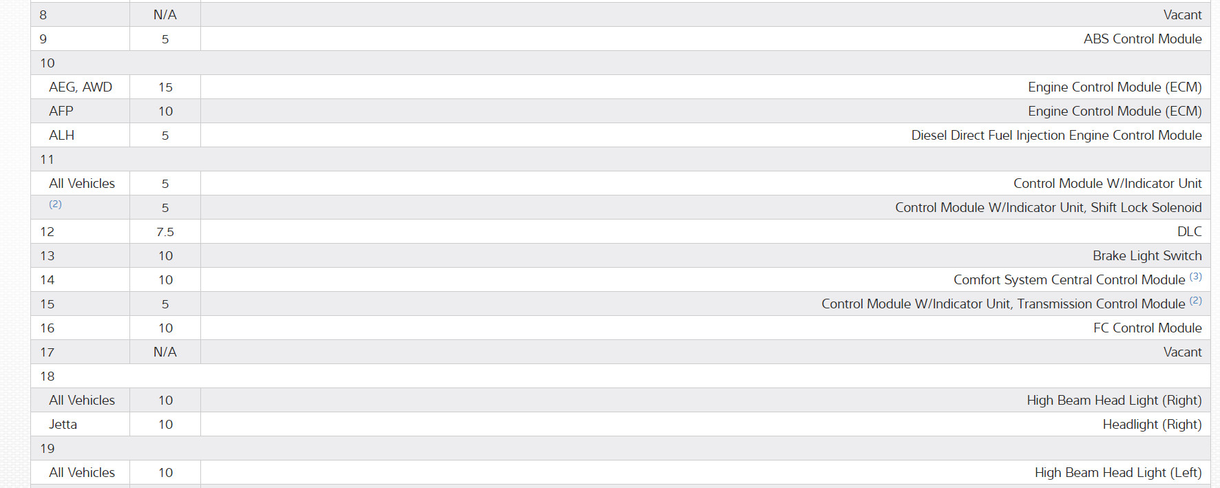

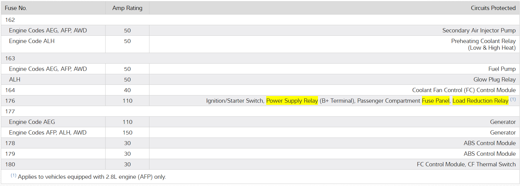

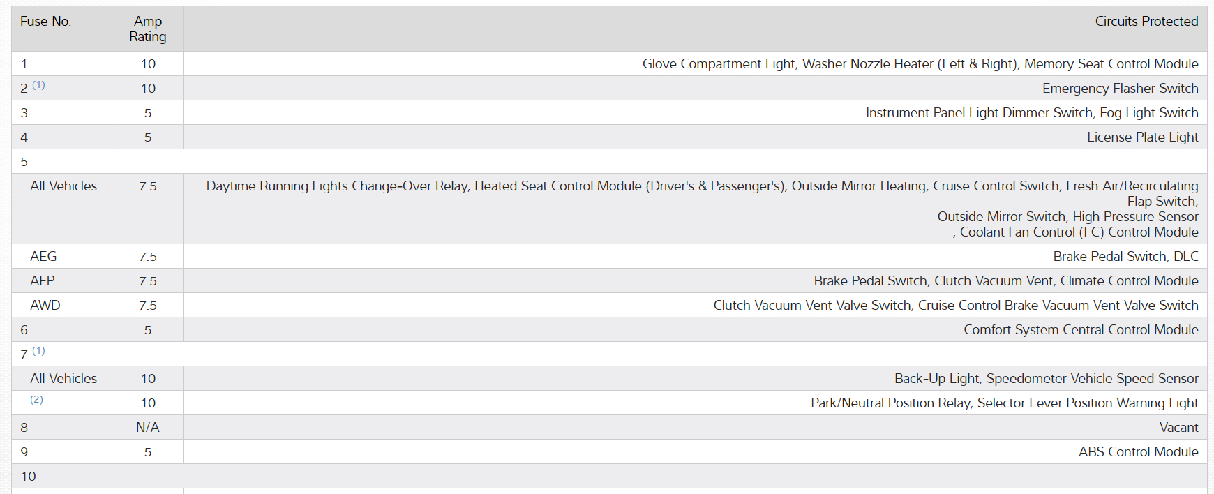

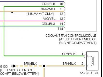

Where is the A/C relay located? The A/C was working fine then it stopped working. The compressor is not turning on. There enough freon.
Monday, July 19th, 2010 AT 6:24 AM
MHPAUTOS
  • 31,937 POSTS
Hi there,

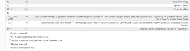

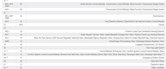

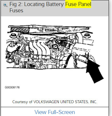

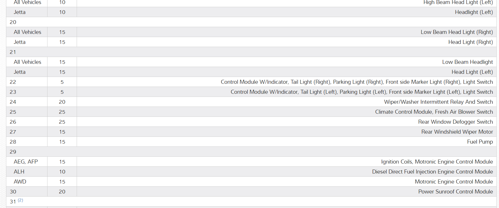

There is no relay as such, the clutch is operated by the control module, i would first check fuses as indicated in the pic below, start here.
https://www.2carpros.com/forum/automotive_pictures/61395_Capture_55.jpg
https://www.2carpros.com/forum/automotive_pictures/61395_Capture1_4.jpg
