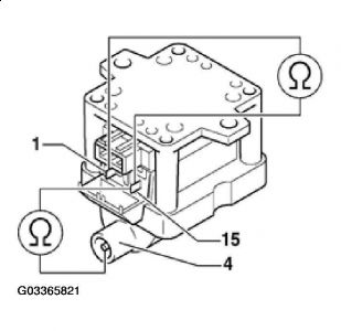

I did what told me to and the wires showed good resistance between them. It came to my mind to check the ignition coil, so I found out that the secondary ignition coil is giving me 4.15 K ohms and the normal should be between 3-4 K ohms. Is that good been a little high? I even unplugged the ignition coil from everything and it gave me that resistance been high on the terminals of the coil.

OK plug wires should be 4.8 to 7.2 ohms. Coil should be Primary checked between term 1 and 15 = .5 to 1.5 ohms and secondary checked between terms 4 and 15 = 2.5 to 4 ohms. Here is the pic for the term locations.

How do you check for resistance between plug wires? The primary gave 0.7 which is ok, but the secondary now reads 4.26K ohms which is more than what it was yesterday. I was checking it for cracks and yeah did found one that is kind of big. So maybe moisture is getting in there and causing it to fail.

Ok if the coil is cracked it could be arcing to ground and not to the plugs. As for checking spark plug wires you remove them ohm them. Let me know what you find.

I checked for resistance on the plug wire and they were good. They couldnt be so bad because I bought a new set last month and replaced them, spark plugs are about a year old. I bought those Bosch Platinum +4. I'm running out of options. The only thing I have is the ignition coil having a big straight crack from one side to the other. I'm going to start looking for prices, so I can get one. Do you think that the ignition coild everytime it got hot, it caused those bad symptoms?

Ok with a crack in the coil that has to be replaced as this can and will cause problems. As for the wires they look ok.

I just wanted to let you know, that my car has no more flu symptoms. Thank u soo much!
