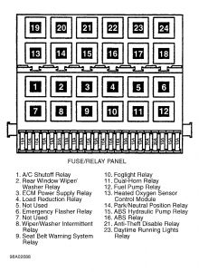

I tryed to find the #23 relay and could not located it so I am add a picture of my relays maybe you can tell wich one it is. The one that has 100 is the new load reduction relay.
Thursday, January 8th, 2009 AT 7:30 PM
DAVE H
  • 13,384 POSTS
Sorry ... i should have added the diagram for you !!
https://www.2carpros.com/forum/automotive_pictures/266999_rel_1.jpg

I tried taken out the DRL Day light running relay number 23 and I still had the same problem. So started to play with the ignition switch and found by moving it around I would lose power to those items. This is a little bit to big of a job for me so I will have to take it to a dealer to the work. Form what checked out it will cost me about $260.00 to get it repaired. Thanks for the help I would recommend you guys anytime.
