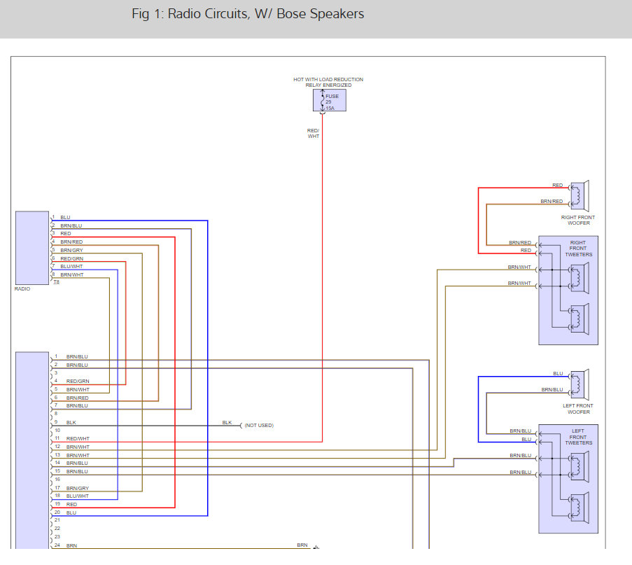

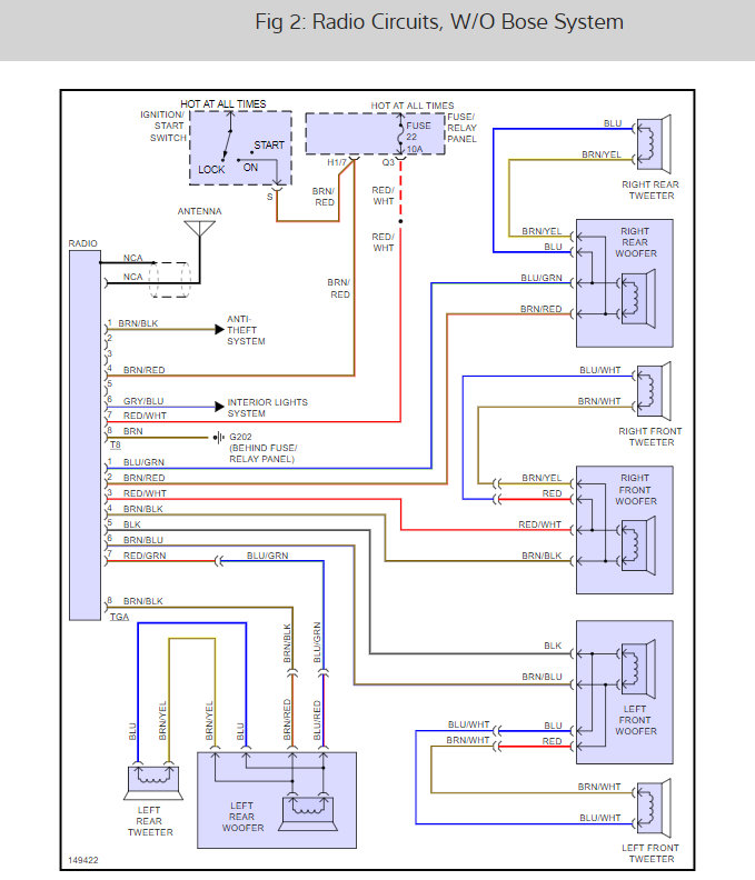

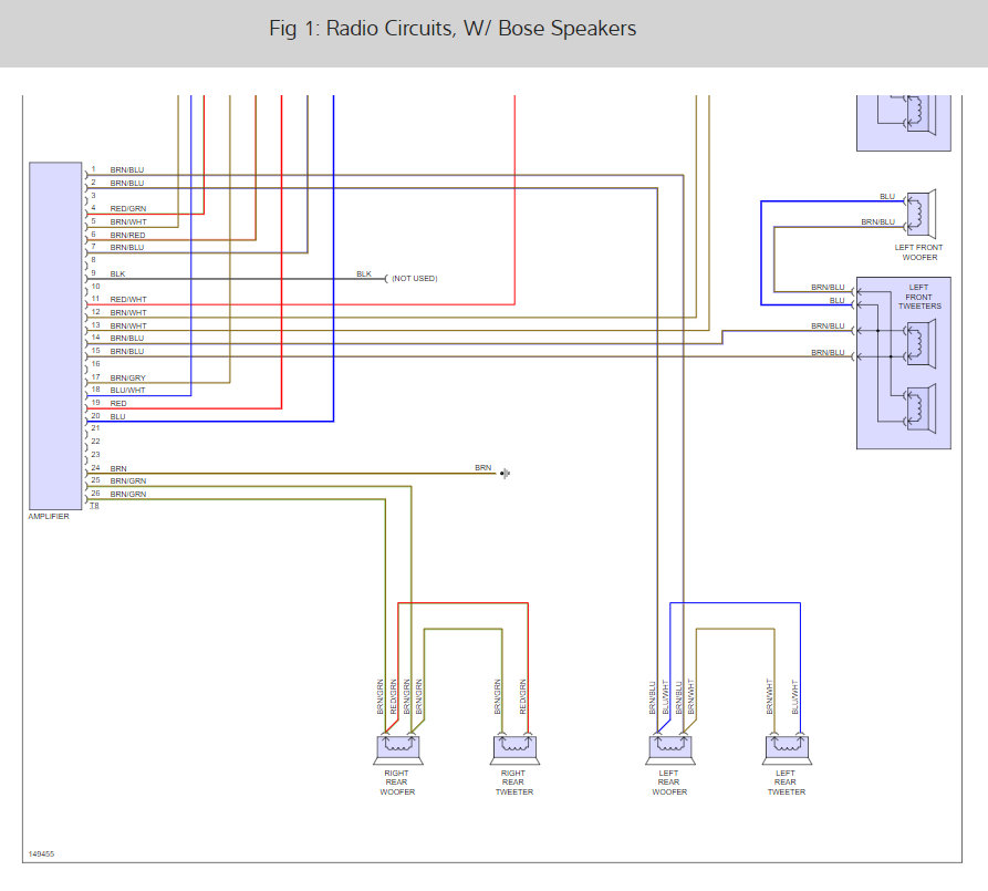

Ok, so i bought this 97 vw jetta trek. somebody cut out the factory radio including the adapters so there just bare wires... i need to know the color coded factory wiring diagram so i can install a aftermarket radio.. i kno BROWN is Ground and RED/WHITE is constant power but i need to know the rest i just keep blowing fuses trying to figure it out.. hope somebody can help me out.. thanks will be very much appreciated!!

Here are the radio wiring diagrams and a guide to help you test the wiring.
