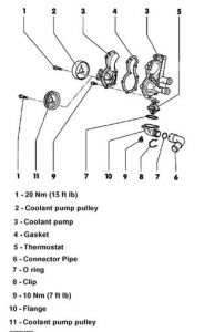

You will have to remove the timing belt covers and timing belt to remove the pump from engine !
Coolant pump, disassembling and assembling
The following list pertains to Fig. 3 .
- 20 Nm (15 ft lb)
- Coolant pump pulley
For ribbed belt
- Coolant pump
Check that shaft rotates smoothly
- Gasket
Always replace
- Thermostat
To check, heat in water
Starts to open at approx. 87 °C (188 °F)
Fully open at approx. 102 °C (215 °F)
Opening stroke: 7 mm (0.28 in.) minimum
- Connector Pipe
- O ring
Always replace
- Clip
- 10 Nm (7 ft lb)
- Flange
For V-belt
Removing and installing, use VAG 1590
Fig. 3: Exploded View Of Coolant Pump

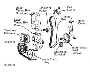

From this diagram could you tell me which pulley you turned and did the belt and pulley turn together at the same time ?
https://www.2carpros.com/forum/automotive_pictures/266999_jet_2.jpg

Thanks for the respond. The photo you sent, didnt realy show, but the 2 belt that I removed was the small belt tha goes from the water pump and a large belt the goes from the alternator. The belt that I didnt removed and accidently shift was the belt that is underneath the black plastic cover at the side of the motor. What is my next step to fixed the problem? Thank you soo much.
Thursday, March 25th, 2010 AT 9:41 AM
DAVE H
  • 13,384 POSTS
The belt behind the black cover is the timing belt. If you didn't remove it. And moved it, the pulleys. (Camshaft and crankshaft)should have all turned with the belt so the timing should not be out !
