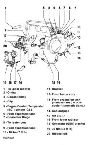

Hello - Thanks for the info but you forgot to answer my questions on my post. It sounds like you have engine oil in your coolant. I have attached a pic of an engine cooling system. Do you have a number 12? If so then this may be where the engine oil is coming from.
https://images.2carpros.com/forum/automotive_pictures/248015_Picture1_51.jpg
Did your transmission level ever go down or you engine oil?

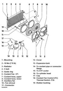

Hello - glad to hear back from you. Since it has been a while I will need an update and answers to the above questions but will ask again to save you time looking back. When you say the radiator only has one line in and one line out........I attached a pic....this is the inlet and outlet hose for the coolant items 7 and 8.....yes?
https://images.2carpros.com/forum/automotive_pictures/248015_1_165.jpg

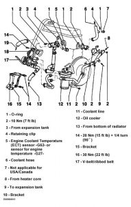

What did you find out about the transmission cooler? When you pulled the radiator you said oil was in it. I have attached the pic for your car. Do you have item 15 on your car?
https://images.2carpros.com/forum/automotive_pictures/248015_2_110.jpg
This is an oil cooler. You may have the oil mixing with the coolant here. Is your oil level going down or your transmission level?

I was unable to find the oil cooler. Is it under and behind the alternator? If not, I don't think I have one.
Am I correct that the oil cooler will be between radiator and engine side, and not on back or firewall side of engine?
to answer questions below: Yes I have 7 & 8
Yes the radiator had oil in it

The oil cooler looks like it should be on the left side if your pulleys are facing front or the front of the engine if they are facing to the passenger side.
I still wonder if you have blown head gasket. Are you having any white smoke out the tail at all? Does it run a little rough at all?
If not – then I would think it is coming from the oil cooler. Check all around the area there since coolant lines go through there.
