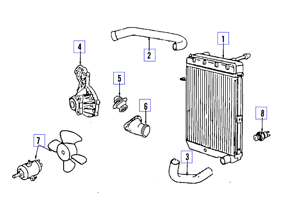

my coolant drains out right after I put it in. The coolant drips out directly in front of my radiator. I can't make out if it is a hose or not. What do you think?

If the leak comes close to the radiator, it could be one of the radiator hoses or the radiator itself.
You might want to do a cooling system pressure test when the engine is cold.
Wait until everything is dry before starting the test.
This might help you find out exactly what is leaking.
