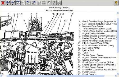

i need to know where the air idle control valve is on my car....thats what i was told is wrong with it...my friend hooked his computer up to it an thats what it said...i looked all over for it i'm not sure where it is located.

Which one here is your engine 1.8L, 1.9L, 2.0L ? For 2.0 below
https://images.2carpros.com/forum/automotive_pictures/12900_iacv_5.jpg
