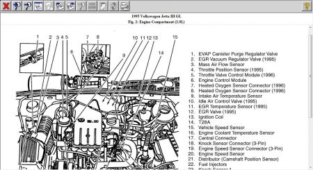

on a 95 vw jetta where is the engine computer located mine is bad need to replace it

In engine compartment see location no.6
https://images.2carpros.com/forum/automotive_pictures/12900_ecm_11.jpg
