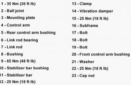

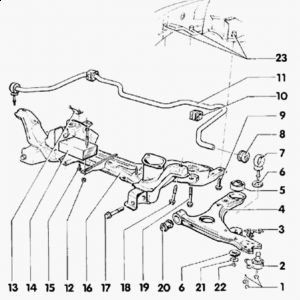

Are you asking about the outer CV Joint? The part with the convoluted rubber boot? Change the entire axle with a rebuilt..Or what appears to be a bent lower control arm? The metal part that attaces to the lower ball joint?Here's a diagram of the front suspension Base models.
https://images.2carpros.com/forum/automotive_pictures/62217_Jeta_1.jpg
https://images.2carpros.com/forum/automotive_pictures/62217_jetb_1.jpg
