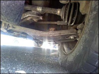

I was turning into my neighborhood, in the snow, started sliding sideways and hit a curb with my front drivers-side tire. From what I can see one part is real bent up; however, I do not know the name of the part.... Help?
The part in question is the lowest horizontal metal part that should be straight.
[img:b3b638cdc7]http://www.2carpros.com/forum/automotive_pictures/462857_482055959_1689866836_0_1.jpg[/img:b3b638cdc7]

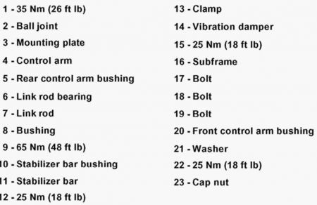

Are you asking about the outer CV Joint? The part with the convoluted rubber boot? Change the entire axle with a rebuilt..Or what appears to be a bent lower control arm? The metal part that attaces to the lower ball joint?Here's a diagram of the front suspension Base models.
https://images.2carpros.com/forum/automotive_pictures/62217_Jeta_1.jpg
https://images.2carpros.com/forum/automotive_pictures/62217_jetb_1.jpg
