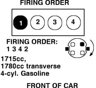

what is the proper configuration of wires on the distributor cap
Monday, June 21st, 2010 AT 6:14 PM
