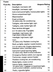

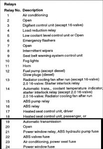

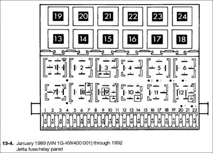

The radiator fan on my jetta will not shut off. Im trying to find the relay to replace it. Can you help?
Sunday, December 21st, 2008 AT 5:59 AM
IMPALASS
MECHANIC
3,112 POSTS
Hello -
I am showing relay 13 or 14 or even both. . .. . ..
