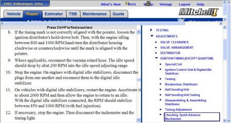

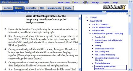

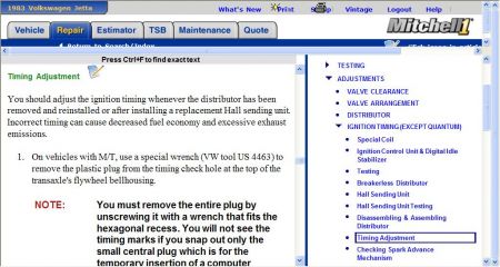

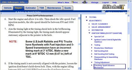

I need the timing specs on the Jetta.
Can not get the timing right. The car will go ok for 2 days and then statrts jerking like it is adjusting the timing itself.
Please tell me what to do.
Thursday, May 22nd, 2008 AT 1:46 AM
MECHANIC
75,992 POSTS
Here it is-see below
