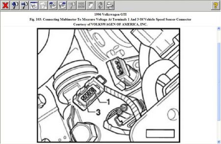

You need to check the speed sensor signal which requires special scanners. Is your scanner capable of testing engine electronics etc? SPEEDOMETER VEHICLE SPEED SENSOR (VSS) SIGNAL, CHECKING Special tools, testers and auxiliary items VAG 1551/1552 scan tool with VAG 1551/3 adapter cable Multimeter (Fluke 83 or equivalent) Connector test kit VW 1594 Wiring diagram We shall check the voltage first if you don't have the necessary scanner. Disconnect 3-pin connector from vehicle speed sensor -1-. Turn on ignition.
https://images.2carpros.com/forum/automotive_pictures/192750_VSS96VWGTI20L_1.jpg
Connect multimeter using test leads from VW 1594 to measure voltage at terminals 1 and 3 of connector. Specification: 9-14.5 volts Turn off ignition. Reconnect connector If no voltage was present: Check wiring.
