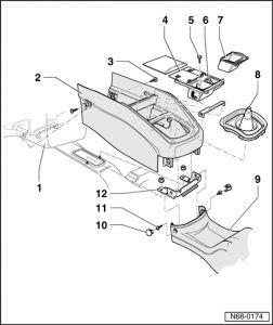

I need to change a broken plastic console and have the replacment parts, including metal pieces to anchor the console to the floor. My question is how do i do the replacment? How to take apart the floor and/or the base where the hand brake lever is? Do I pull up the floor mat, disassemble the console, snap off some plastic part?
Thanks

Heres a picture of the console, this should help you in removing it, shows locations of screws and bolts used to hold it together.Hope this helps
https://images.2carpros.com/forum/automotive_pictures/1639_vw_1.jpg
