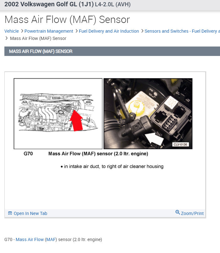

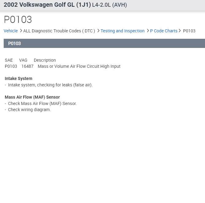

hi, my engine light is on and i checked it and gave me p0103 code. looked it up and replace the mass air flow sensor, and still gives me the same code.

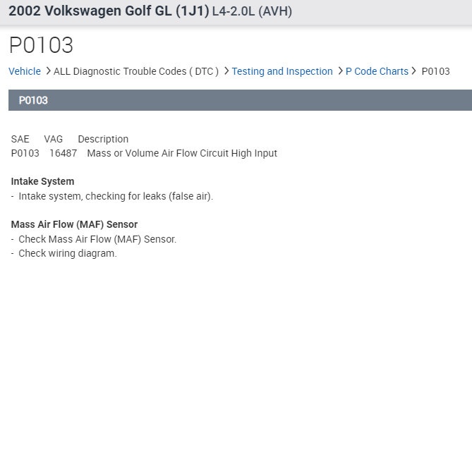

The code P0103: Mass or Volume Air Flow Circuit High Input

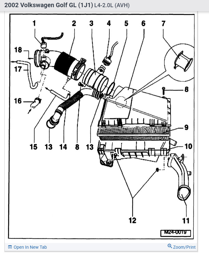

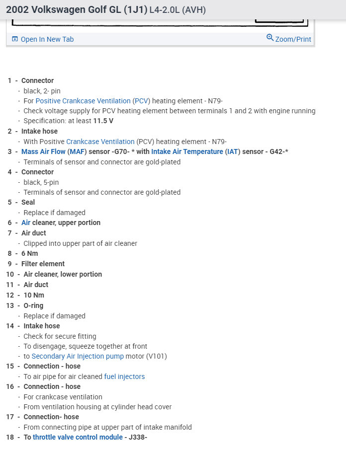

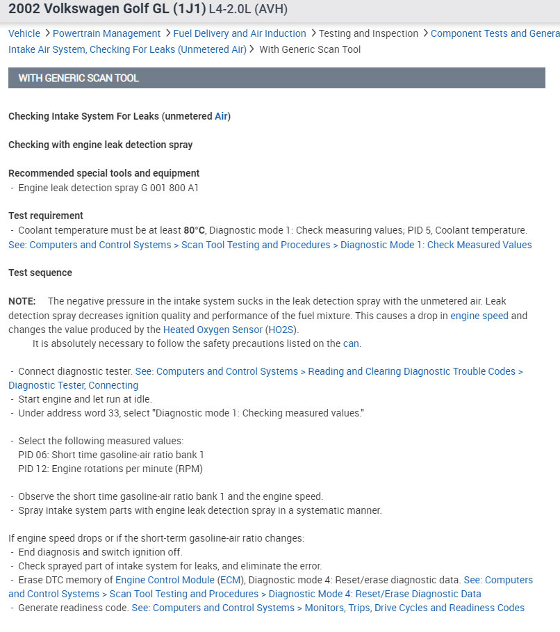

One of the reasons for this code can be triggered is due to a leak in the air intake tubing.
Check for any loose connection or crack in the intake tubing.

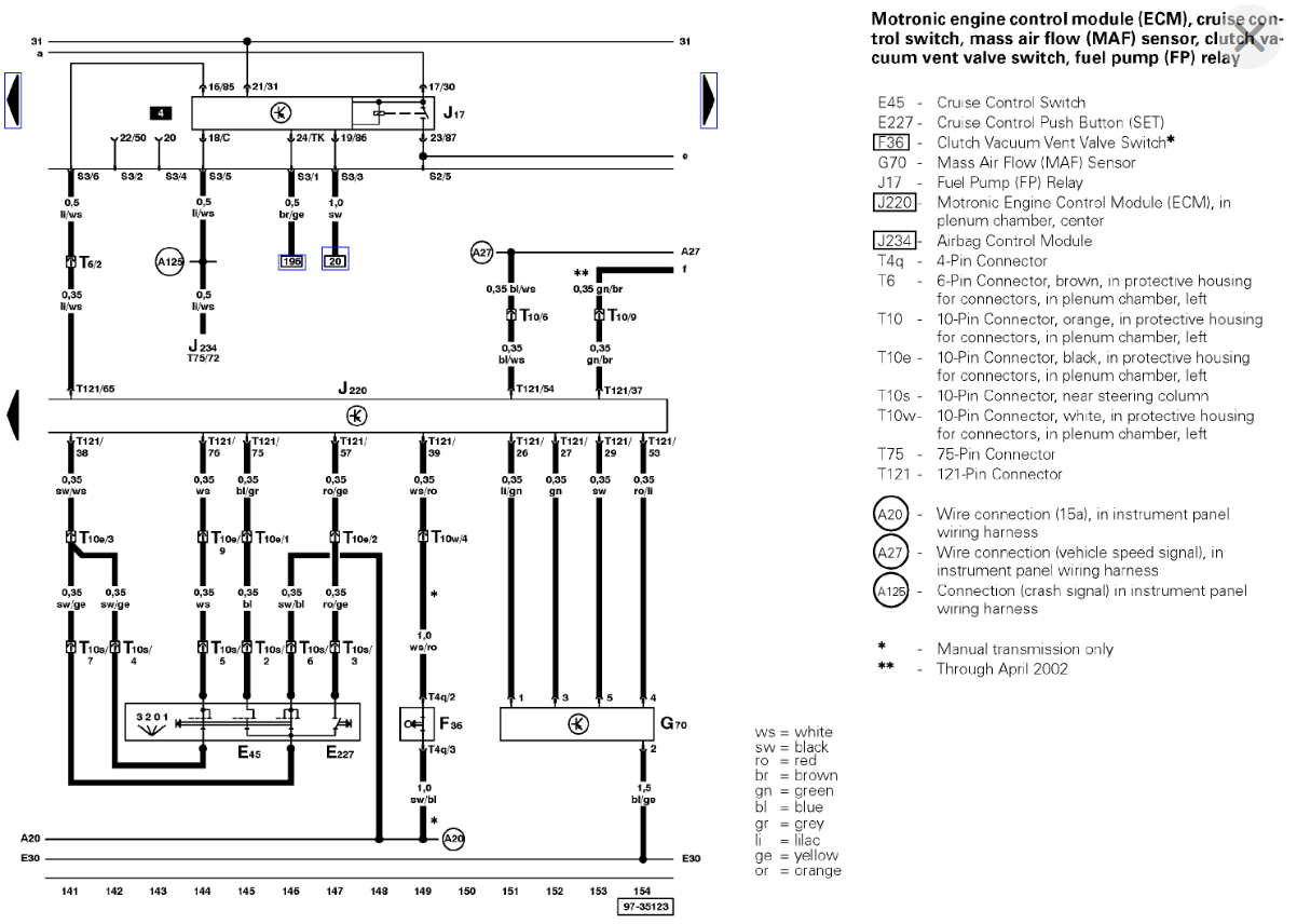

Another possibility is a faulty wiring to the mass air flow sensor.
I have attached diagrams as well as the leak test procedure below.
