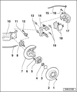

HOW DO I GREASE AND PACK WH EEL BEARINGS AND C HECK BRAKES FOR BRAKE DUST, CAR SAT FOR ALONG TIME WIT HOUT BEING DRIVEN

Disc brakes all around, the rears need a tool to turn the pistons back in, bearing is a one piece sealed bearing, dont do anything to it, unless it gets noisy.
