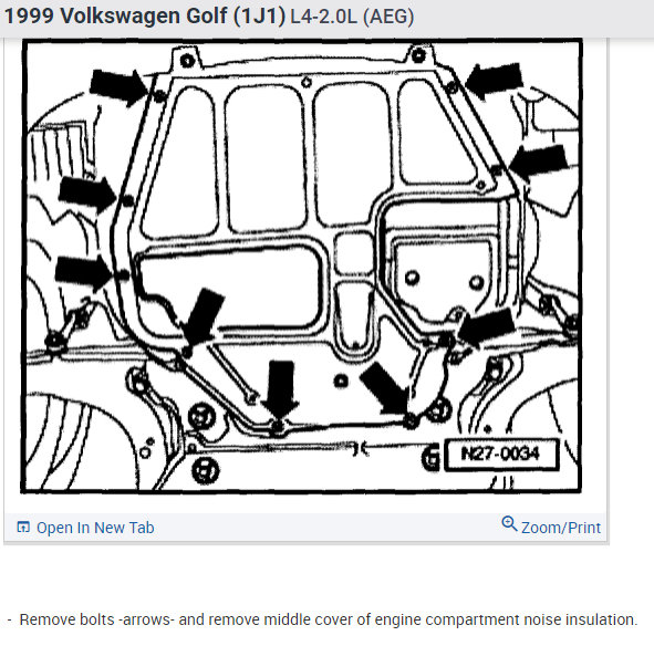

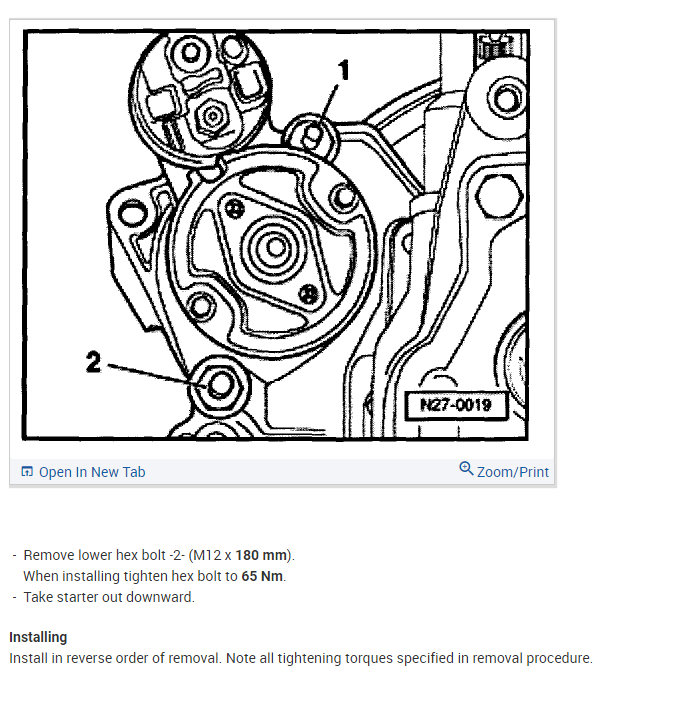

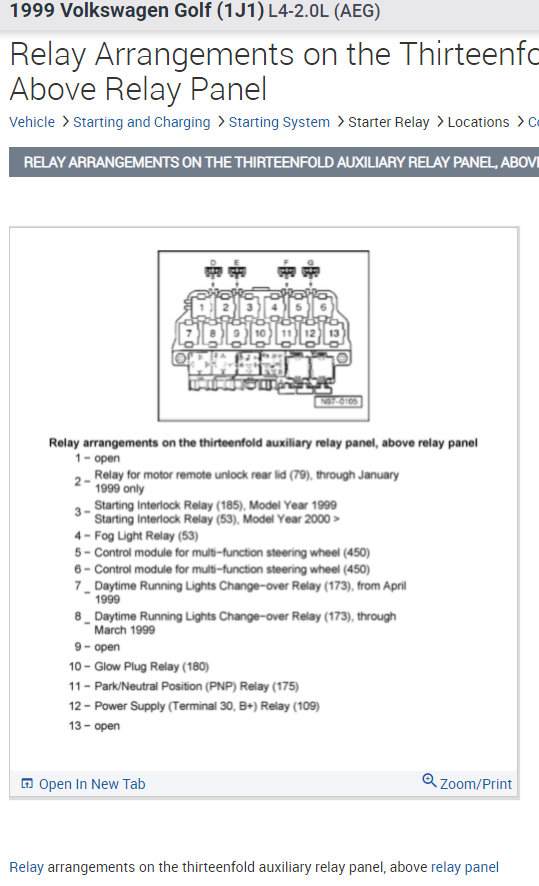

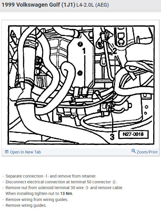

You could have a inoperative starter due to a faulty relay, wiring or bad starter motor.
First check the relay. It is located under the hood fuse block (see diagram).
Visually check for corrosion and burnt pin(s).
You can also test the relay:

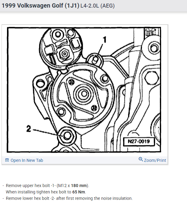

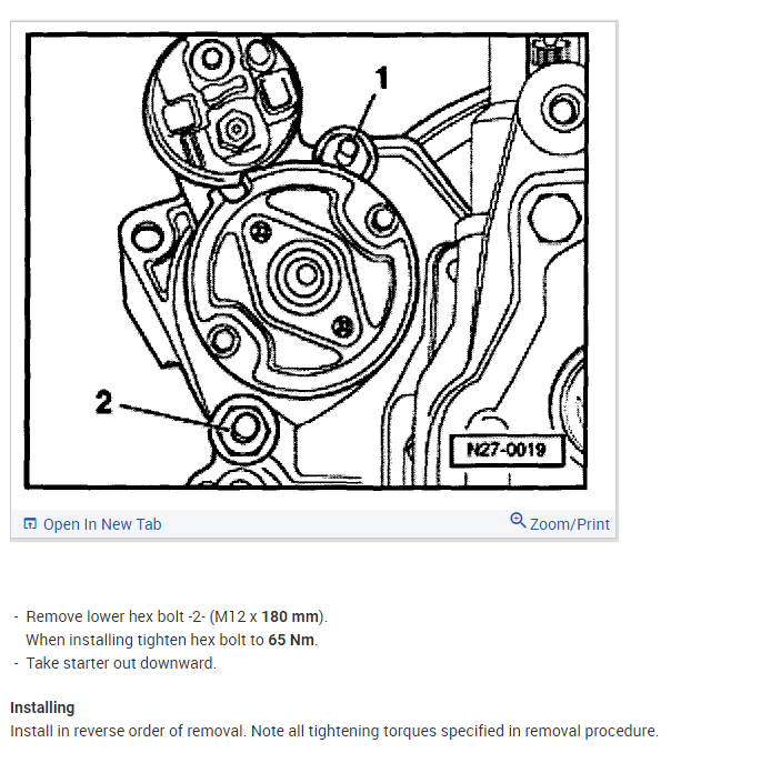

Also check the wire that attaches to the starter and make sure it is secured. A loose wire can trigger no start.
If you have a good relay and good connection then it is likely a bad starter.
