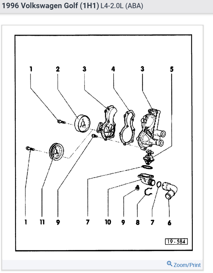

Hi Folks,
With me, I have a mk4 golf. I recently had a breakage on one of my radiator tanks. I opted to have a metallic tank fitted instead of replacing the whole radiator. After the change, I noticed that the temperature gauge rises to 90 within a few minutes of engine run (than it used to do before). It is getting me worried. So every time I park, I have to check my radiator to see if it is leaking. Is there anything or nothing to worry about?
Thank you in anticipation for your help.
Sep 10, 2018 at 12:07 AM
  • 55,562 POSTS
When you fixed the radiator did you replace the thermostat? Also, is the engine overheating or leaking coolant? Here is a guide to show you how to replace the thermostat stet by step and a diagram below to show the location for your car:
