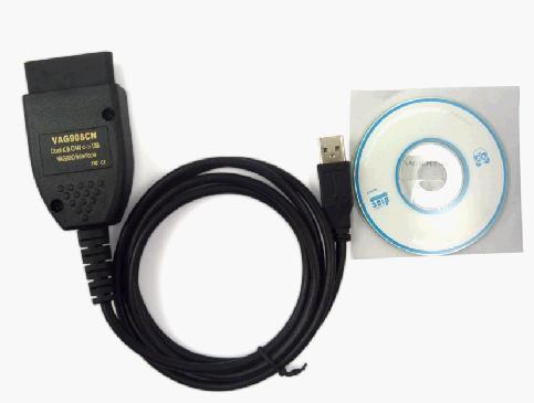

well up till now i have not yet found a solution my problem is even compounded by the fact tha i now have the PC software for diagnostic scans but i just don't have the VAG cable to coonct from from my laptop o the car.I wish i had that cable i am sure by now i would have gone far with some form of solution.
Hoping to hear from you soon.
