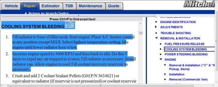

I recently installed a new water pump and thermostat on my VW Golf, but the water aint flowing properly thru the system, I believe there is air inside it, but I would like to know how do I bleed the air out? Is there a purge valve and where is it located at? Please help! Thanks! wilson_aguilar@sbcglobal.net

Generic bleeding:
https://images.2carpros.com/forum/automotive_pictures/12900_bleeding_3.jpg
