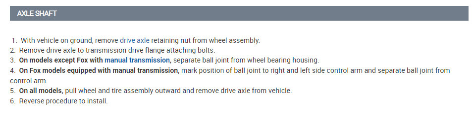

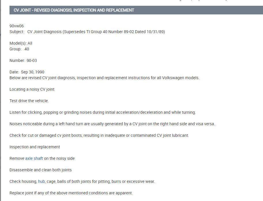

When i accelerate through turns from a full stopped position i heara clacking sound. it sounds like its coming from the front axel, but i dont know for sure. Any ideas??
Dec 20, 2008 at 10:30 PM
This noise is the CV axle that is clicking. This is common when they fail and the repair is to replace them or rebuild them. They are pretty cheap so I would just replace it.
Here is a couple guides that will help with this:
https://www.2carpros.com/articles/clicking-sound
https://www.2carpros.com/articles/replace-cv-axle
https://www.youtube.com/watch?v=XeqT-_fwVQg
Below is the info from the manual that will give additional details on how to replace this. Please let us know if you have other questions. Thanks
