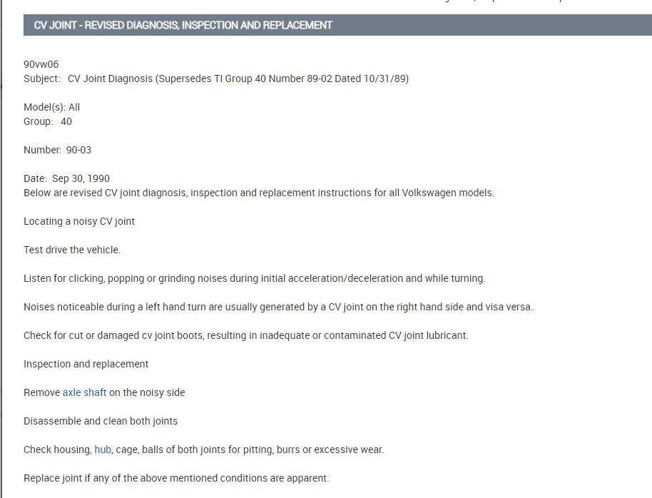

When i accelerate through turns from a full stopped position i heara clacking sound. it sounds like its coming from the front axel, but i dont know for sure. Any ideas??

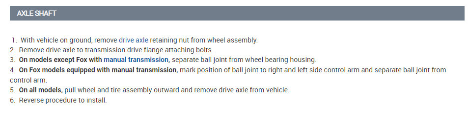

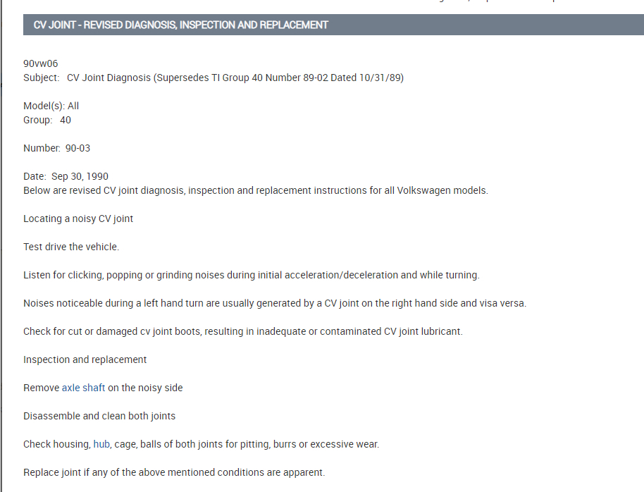

This noise is the CV axle that is clicking. This is common when they fail and the repair is to replace them or rebuild them. They are pretty cheap so I would just replace it.

Below is the info from the manual that will give additional details on how to replace this. Please let us know if you have other questions. Thanks
