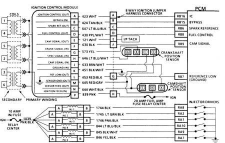

IS this statement still true: "i can spray starter fluid and it will start for about 2 seconds and cuts right back out" Try unplugging the sensor and try starting it.
https://images.2carpros.com/forum/automotive_pictures/30961_lss_1.jpg
Oct 30, 2010 at 12:57 AM
MYLES74
  • 19 POSTS
yes it will start for 2 0r 3 seconds and will cut right back out with starter fluid..so you want me just to try and unplug it and try to start it? dont plug it back in before i start it? or plug it back in? and thanks for the diagram! couldnt find it anywhere!

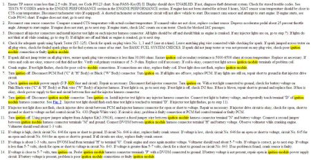

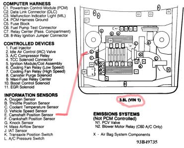

No problem on the post...just makes it hard to help. Also try unplugging the cam sensor to see if it starts. On this one it will affect fuel delivery. Also the coolant temp sensor can. Please check for any current codes. Dumb question but is there enough fuel n the tank....don't want to skip the basics and don't assume the gauge is right.

doesnt the check engine light have to be on to pull codes? and i was told that i can only pull codes if i have a 96 and up? mines a 94..advance auto said i will have to take it to a shop and get a specail machine hooked up to pull codes on a car that old. and there is no way to get it there cuz it wont start. and yes it has about a half a tank of gas. thought about that myself.and just unplug the sencor and try and start it? dont plug it back in before i try?

Codes may still be present regardless of the cel.
You need the correct scanner.
Try unplugging the crankshaft pos sensor and the coolant temp sensor independently.
When you unplug the cam sensor, the pcm use a last known data. Cam sensor is not the problem based on that.
