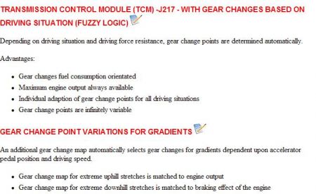

Hi there, I just can't find anything on this all i keep coming up with is this....
https://images.2carpros.com/forum/automotive_pictures/61395_Noname_90.jpg
I can get all the info on ratios , gear sets teeth counts etc, but nothing else, i will keep looking but i don't know if will do any good, here's hoping. Mark
