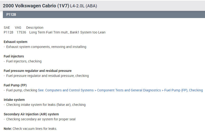

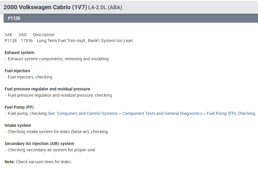

what is the testing for code of p1128?
Jun 30, 2010 at 9:17 AM
DANNY L
  • 5,648 POSTS
Hello, I'm Danny.
Here is the information you requested. This is the information I found for Code P1128. This code is for a Fuel Trim issue. I've attached a picture below for this code showing what to check for. Hope this helps and thanks for using 2CarPros.
