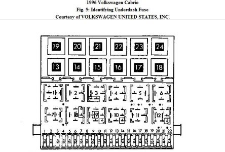

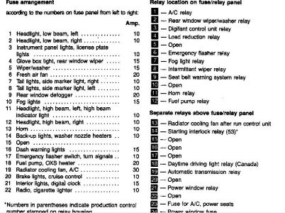

REPLACED FUEL PUMP, AND FOR SOME REASON I HAVE NO POWER GOING TO THE PUMP, THE RELAY IS GOOD, HELP. i NEED TO FIGURE OUT WHICH FUSE IS THE FUEL PUMP FUSE. i CAN'T FIND A DIAGRAM
Feb 21, 2009 at 4:57 PM
DAVE H
  • 13,384 POSTS
Hello .. thanks for the donation .. much appreciated Hope this help's .. let me know if you need any more information ! Fuse # 18 ...relay # 12

It was great found that fuse change it an they work great .
Thanks
