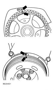

2001 Volkswagen Beetle Need timing diagram
2001 VOLKSWAGEN BEETLE
150,000 MILES • 4 CYL • 2WD • AUTOMATIC
BECKY HENEGAR
Had to replace water pump took timing belt off and need to know how to set timing
Apr 23, 2010 at 8:29 PM
MHPAUTOS
  • 31,937 POSTS
Hi there, re set timing marks as per pic, Mark (mhpautos)
