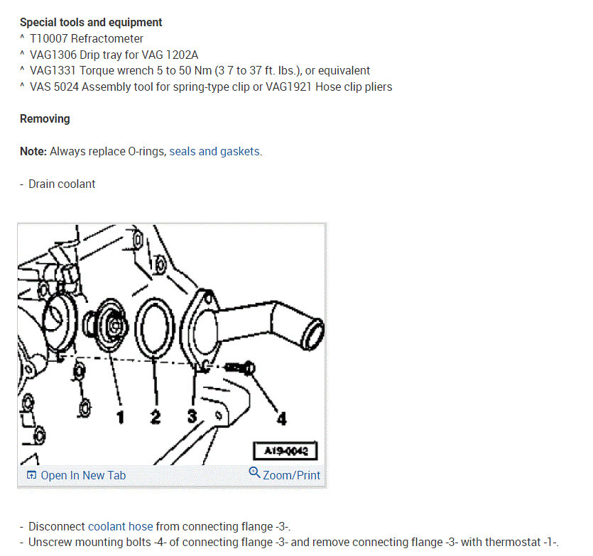

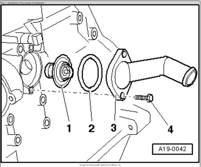

Where is the thermostat located on my car?
Apr 25, 2010 at 3:09 PM
  • 75,992 POSTS
Looks to be on the side of the engine, about half way down
Read the guide below on changing a thermostat, not vehicle specific but will give you an idea of what you are doing
See the diagram below for location/components of the thermostat and housing

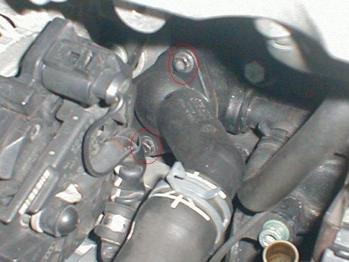

I need to replace the thermostat on a 2000 2.0 turbo beetle. However, I can't seem to find the thermostat location. Thanks
Nov 10, 2018 at 7:44 AM (Merged)
JIS001
  • 3,412 POSTS
You need to remove the alternator. Thermostat housing will be behind it. Attached picture. Why are you replacing the thermostat?

Replacing the thermostat isn't too difficult to do. Make sure you have a place to put the old coolant after it's drained. You don't want any animals drinking it.
To get you started, here is a link that explains how in general one is replaced. You can use this as a more detailed guide when doing the job. The directions specific to your vehicle are attached in the pics below.
If you look at the pics below, the location of the thermostat is indicated.
