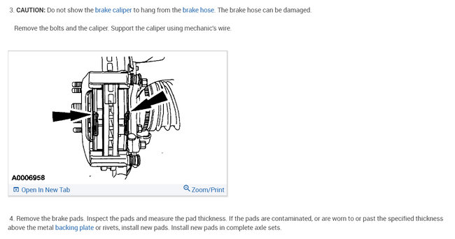

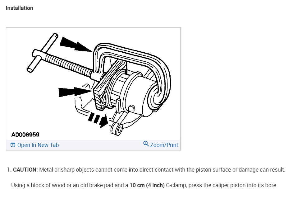

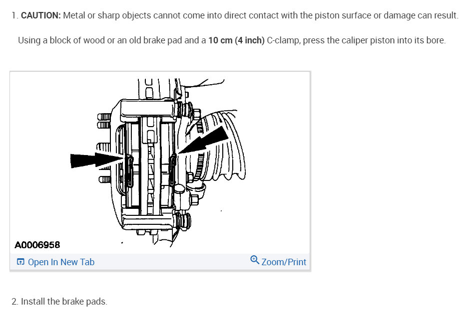

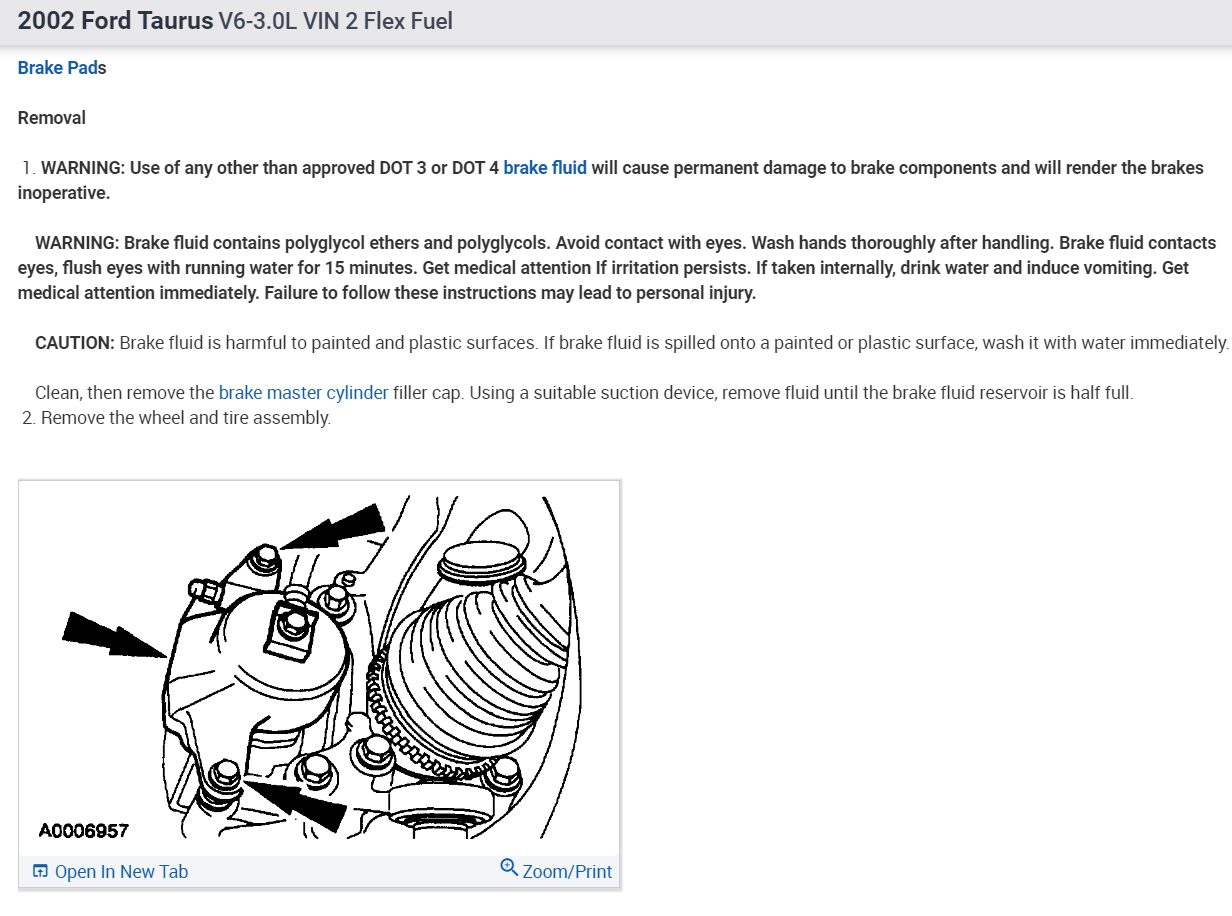

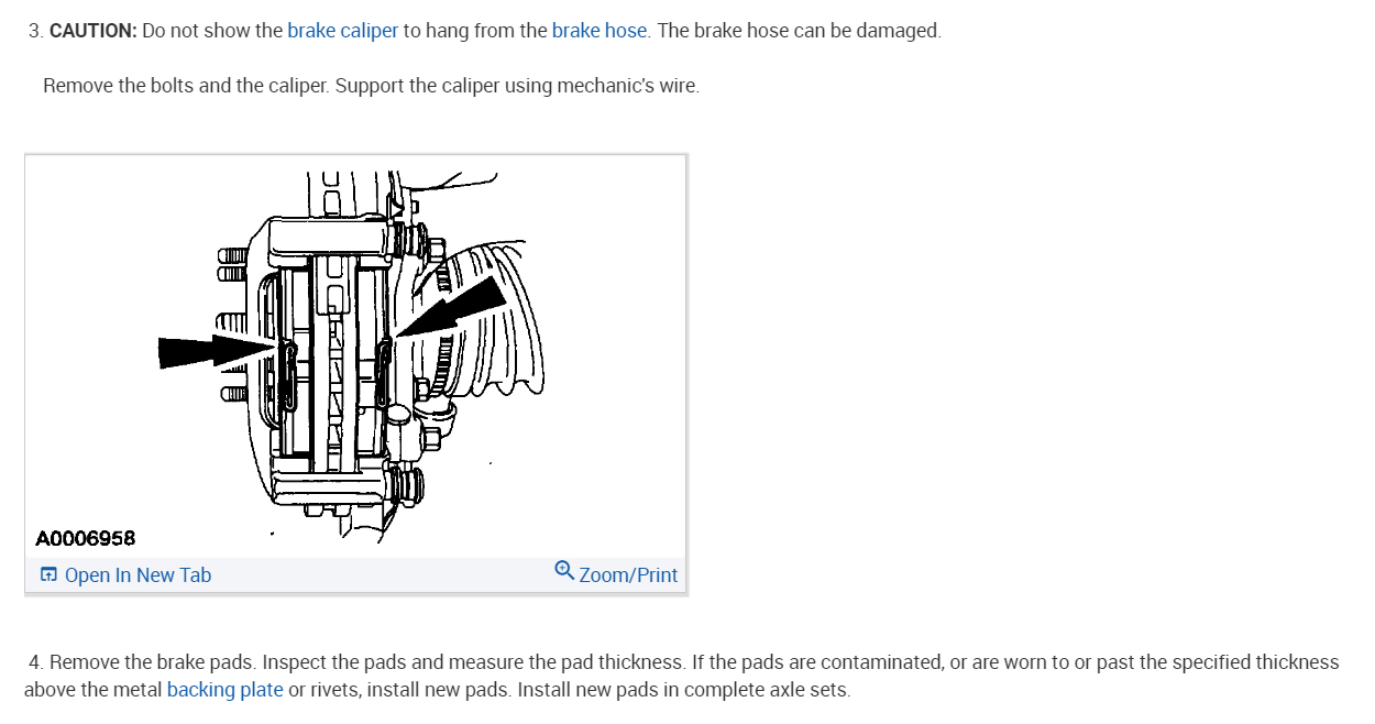

Under normal braking conditions they should last about 5,000 miles. here is how you can replace the front brake yourself and save some money. The pads will cost $30.00 link below.
https://amzn.to/3KI1drO
Also here is a guide to help you raise the car and remove the wheels. Go over the guides before you begin.
