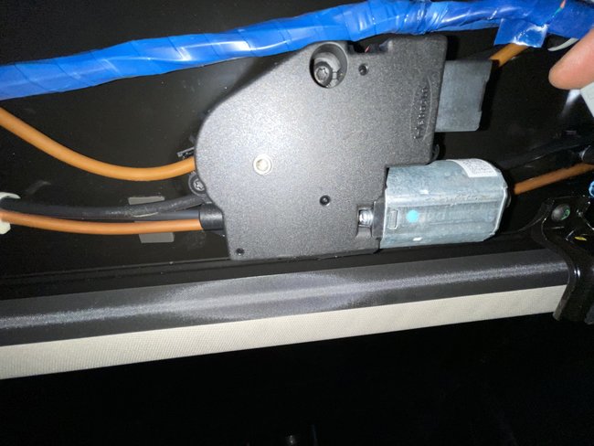

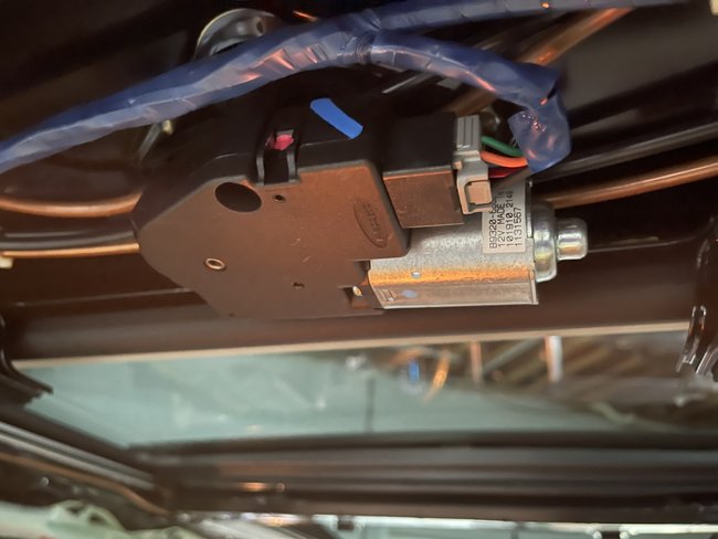

Took the headliner down and the motor that makes the noise is the one in the back, i guess the sunroof motor is in the back and not the front? Looked up the numbers and it says sunroof motor, just clicks. I think it is weak and may have broken plastic wheels inside it.
Aug 26, 2021 at 2:37 AM
DIVIDES
  • 903 POSTS

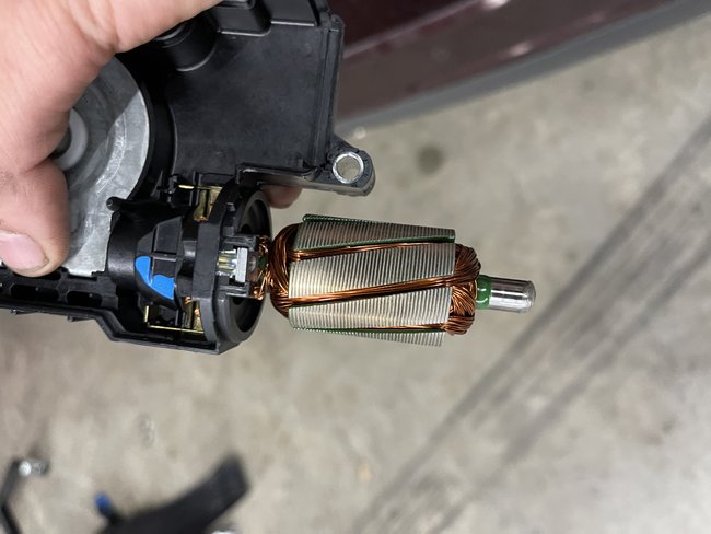

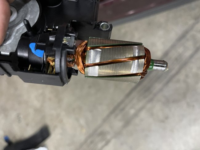

Wow, there are two motors next to each other, i guess one is for tilt. I opened the slide one and this is what i found. Is this normal?

I see what I did. Do you have a motorized sun shade as well? They list these separate and so I would have to assume this other motor is the sunshade.

Ya, cleaning would not be an issue, am good at that, thanks for the instructions. Ya, you are right about the sunshade. I think the sunshade does not fully open, like not 100% and the clicking starts as soon as its about to wind, so wither the shade's not finishing up opening is the issue or the other motor is not working, they are both the same. but based on the pictures i sent you i an not sure this is how they supposed to look on the inside.
Aug 26, 2021 at 11:24 AM
Oh shoot. I forgot to attach this. Sorry. I have not taken these specific motors apart before but have seen enough motors and windings to know I have not seen these marks before.
See attached picture of your picture.
I don't know how they would get there to think they are abnormal but all I can say is I have not seen marks on them like this before.
This is an assumption but that could be an issue with getting the motor to turn. Normally you find an issue with the windings but this is clicking which I can convince myself that this could cause the issue.

Ya, that is what I am thinking. I have seen starters, and other motors but nothing like this, i will see once the replacement is here.

It was that motor. Installed it and initialized the motor and all is good. Thanks for your help.
