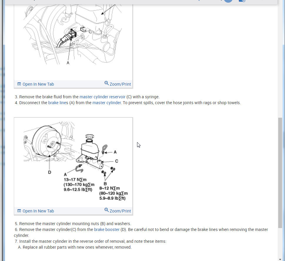

So I have a problem where no matter what speed I am going when I apply the brakes the pedal sinks like the brake master is by passing so I need to replace it can you help?
May 29, 2020 at 2:18 AM
Here is a guide that will help with this:
https://www.2carpros.com/articles/how-to-replace-a-brake-master-cylinder
https://www.2carpros.com/articles/how-to-bleed-or-flush-a-car-brake-system

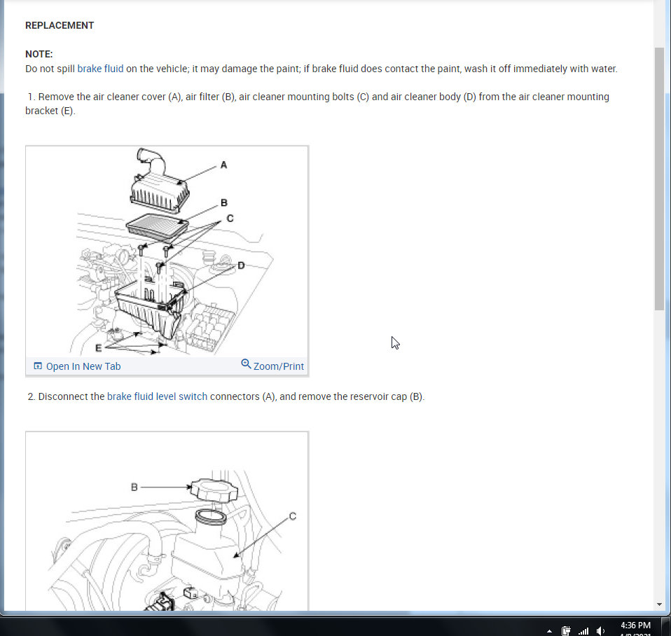

Plus here is the process below from the manual on how to replace this.
Please run through this material and let us know what questions you have.
