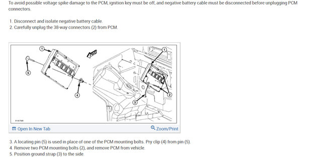

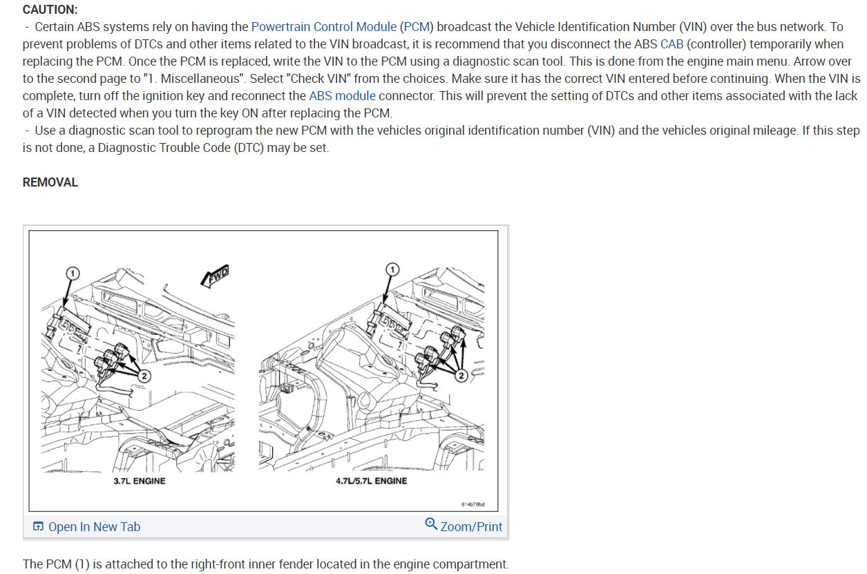

PCM replaced and didn't match my vin. should i rewrite VIN?
car didn't start .
i don't have pin code reprogramme the PCM.
i use Ap 200.
Apr 15, 2021 at 2:29 AM

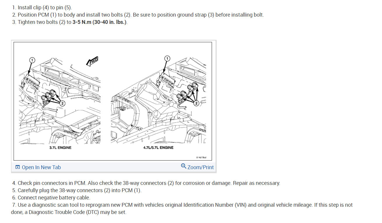

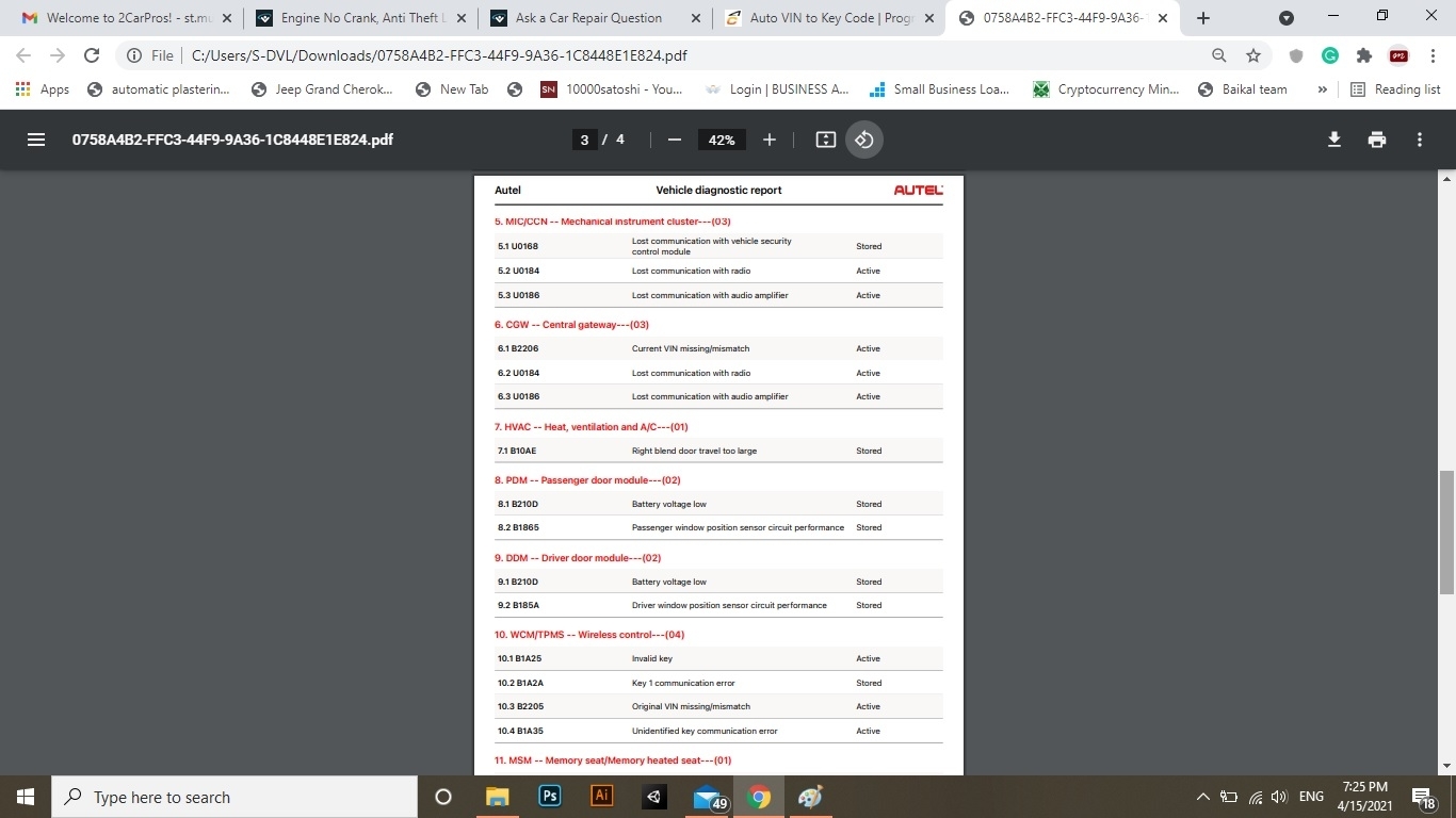

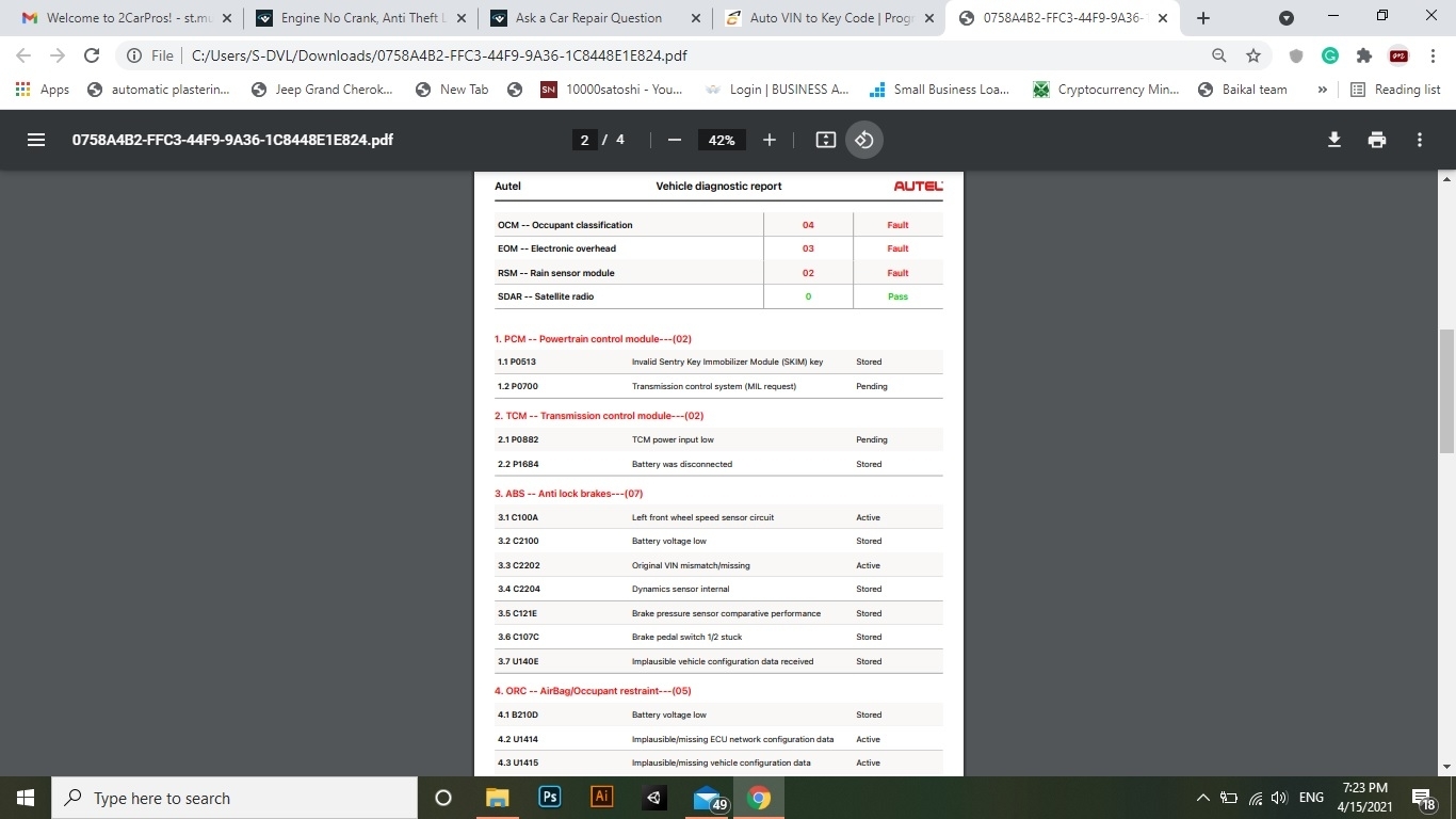

Good afternoon,
The VIN has to be changed as well as the mileage from the old cluster.
Do you have access to Tech Authority for Chrysler to program the module? I do not see that option on your scan tool.

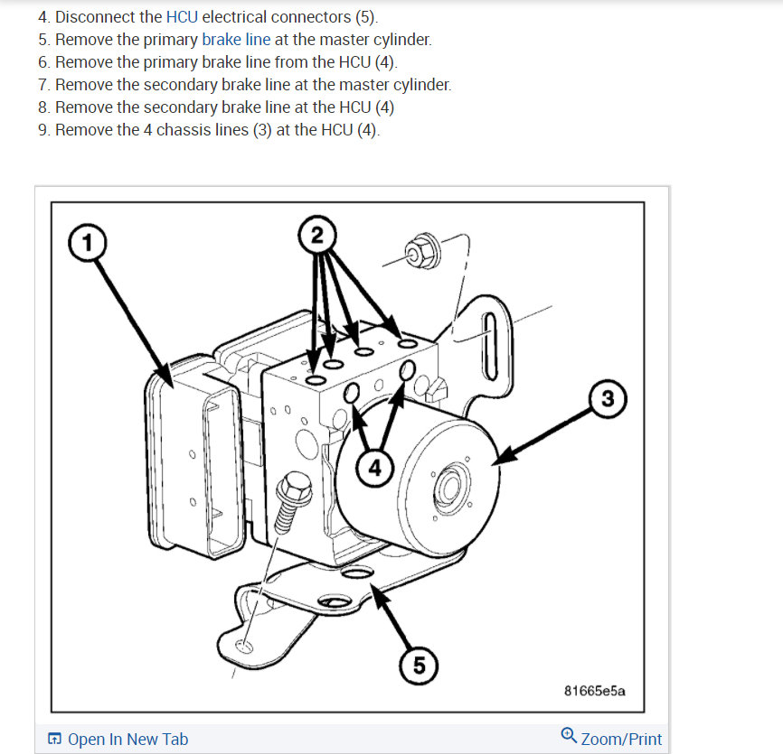

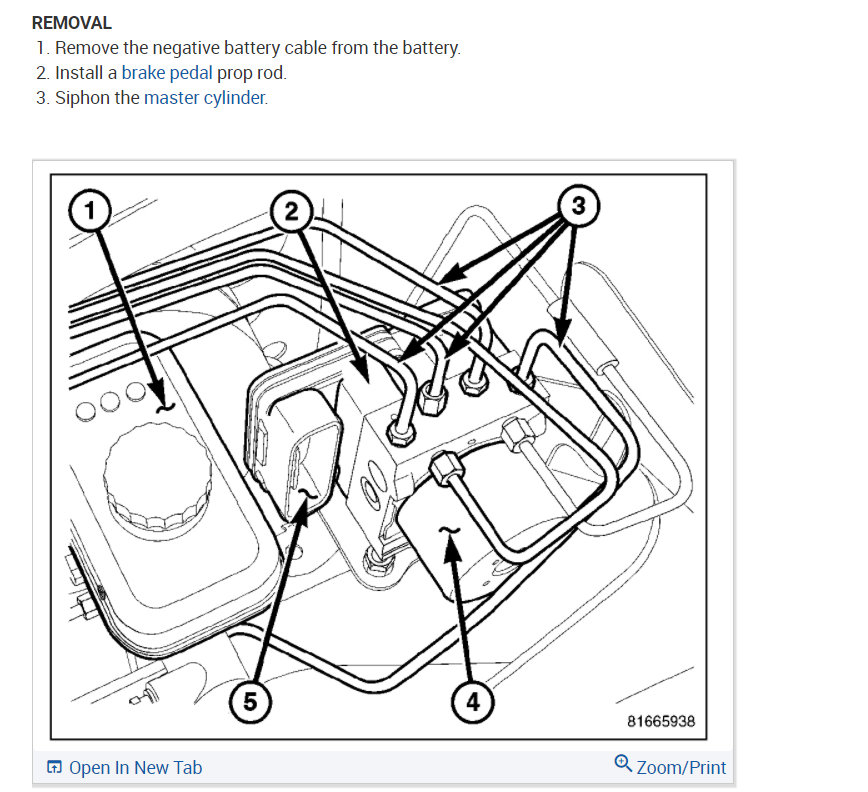

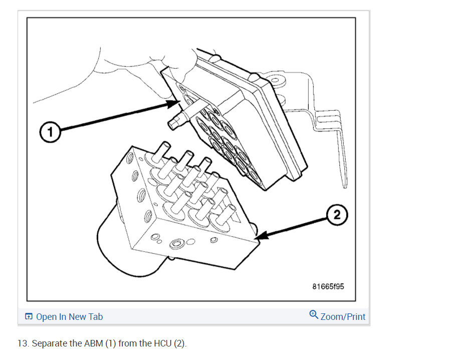

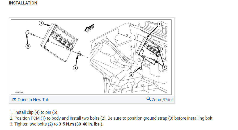

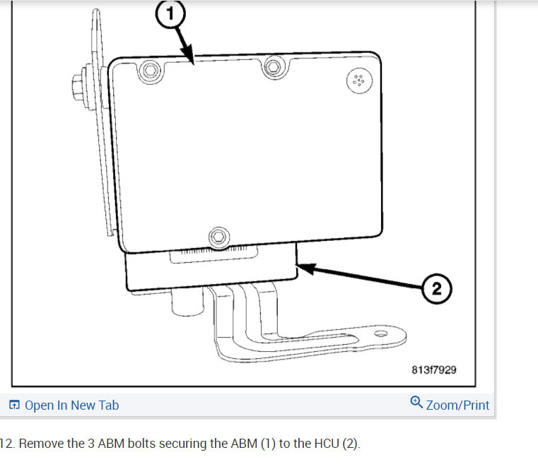

where is ABS cap it mention in photos you are sent?
Apr 15, 2021 at 7:32 AM
You mean the ABS cab or control unit. Like it says, some of the models built put it in the way and it must be removed to access the ECM.
https://www.2carpros.com/articles/how-to-replace-a-abs-controller
I attached the procedure below for you.
Apr 15, 2021 at 7:38 AM

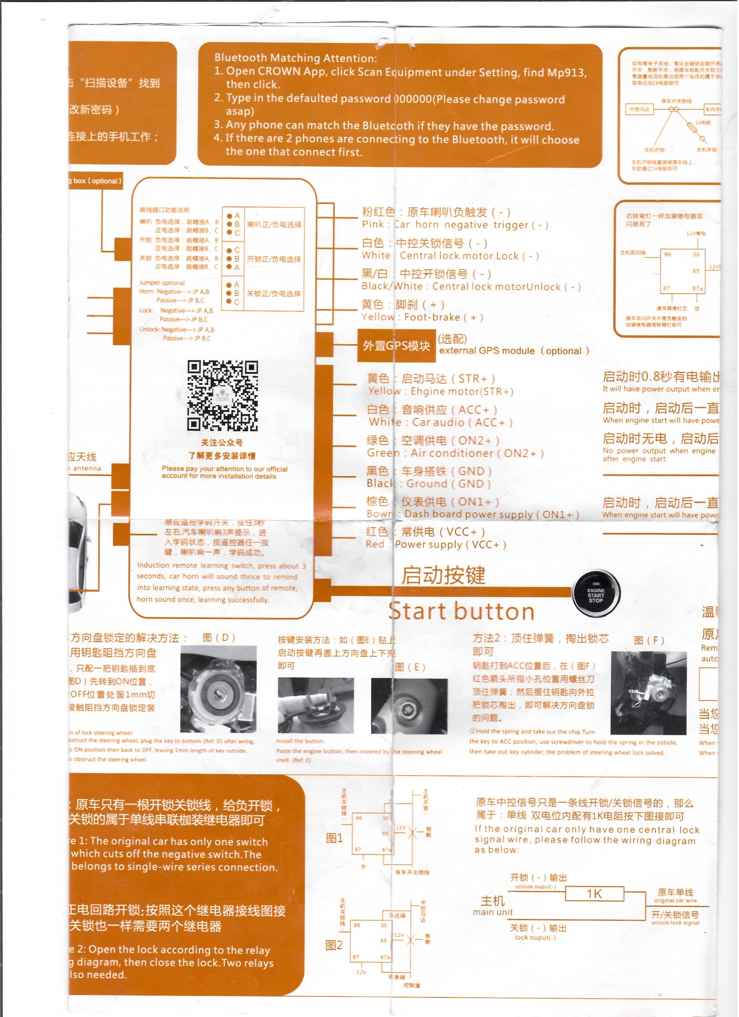

thank you for the valuable information. if i want to install a push-button start for the car.
Acc in switch it takes ground (-) but push-button device it give (+) so i try to use resistant and relay is that right way and how i should connect resistant and relay?
and lock and unlock wire for device give (-) how also connect device wire.
Apr 15, 2021 at 7:56 AM
You mean trying to start it without programming the ECM? If you do, no, it will not work. The ECM will not allow spark and fuel until the ECM is on board with the rest of the modules.
