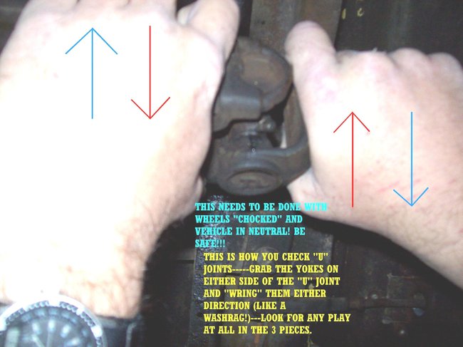

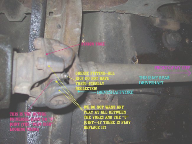

Have you physically checked your universal joints?
Here is a link from our "repair guides":
https://www.2carpros.com/articles/how-u-joints-work
Here are couple of pictures I made of my Willy's Jeep's U-Joints, yours should sort of be similar.
