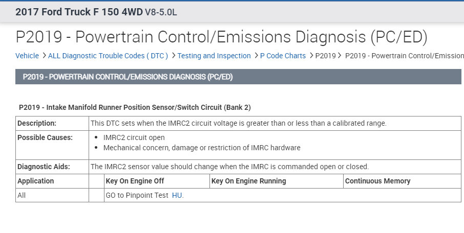

P2019 is coming back as "intake manifold position sensor or switch circuit bank 2". I again did very brief research and what I have found is that this could be caused by a bad sensor (not sure yet which sensor exactly or where it's located) or the entire intake manifold itself could be damaged and need to be replaced. Why in the world they would make an intake manifold for a truck out of plastic, I don't know. What is even harder to understand is how Ford is charging $700 for factory new ones. That's 70% of the cost for a whole new set of heads, complete with valves, camshafts and hardware, for a bunch of plastic pipes. Anyhow, gripes about Ford aside, I think I read that this fault could starve the engine of oxygen and cause power loss at higher RPM, or cause the engine to not want to go into the higher RPM range. I might be experiencing that, but I'm not sure. Even if that is happening though, it definitely doesn't coincide with the timing of the vibrations. I don't know if this could still be causing vibrations some other way though. Could this cause misfiring? Would misfiring cause the vibrations I'm feeling?

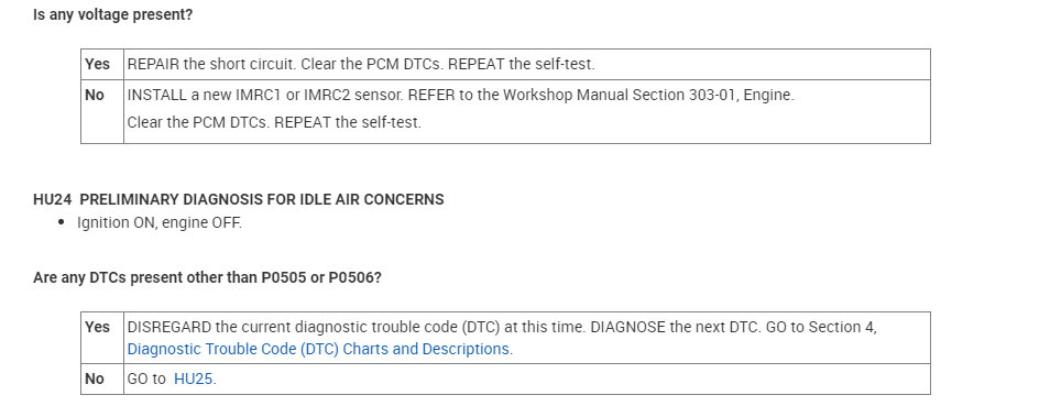

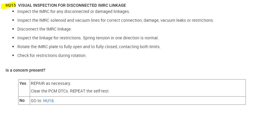

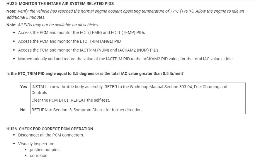

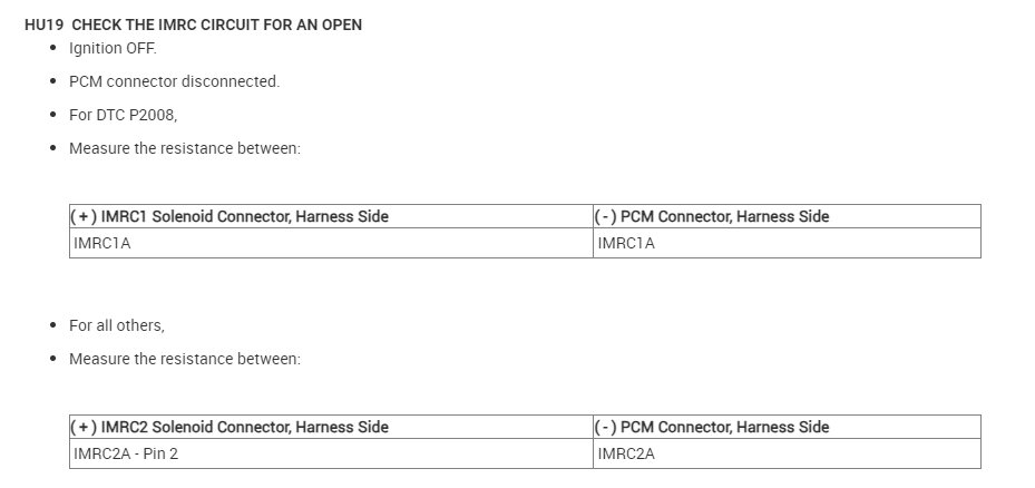

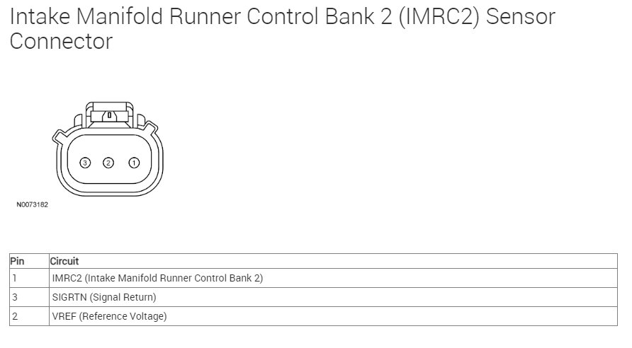

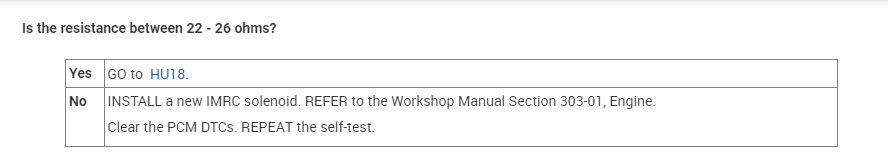

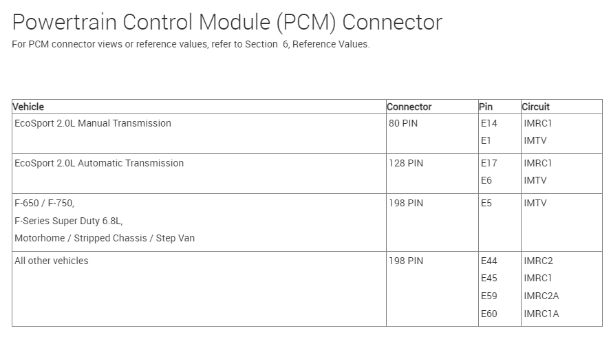

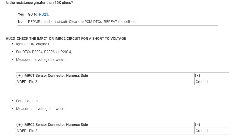

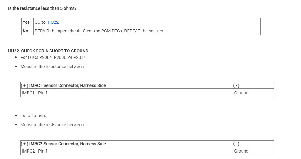

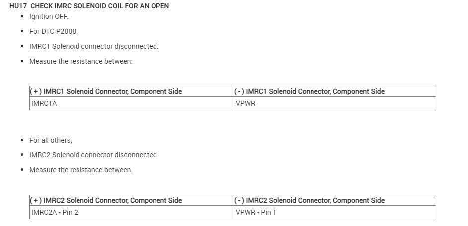

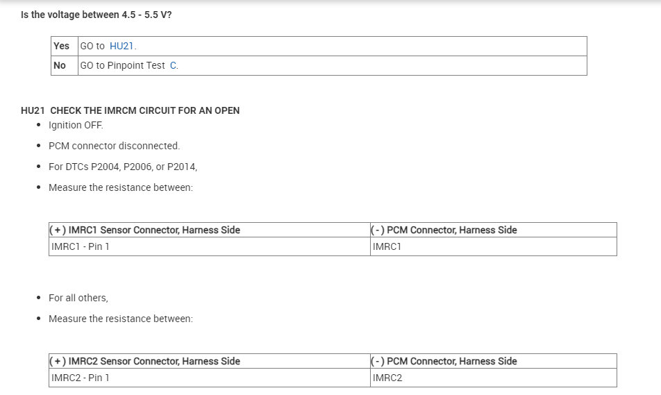

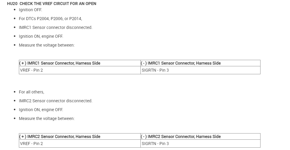

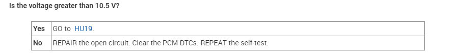

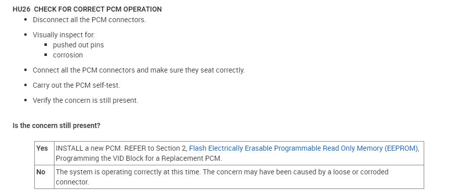

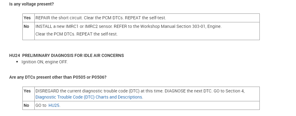

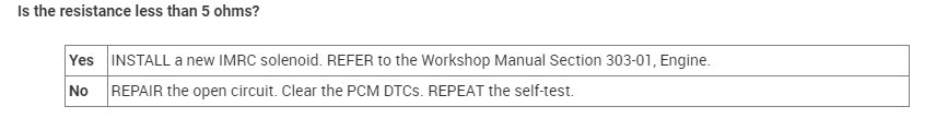

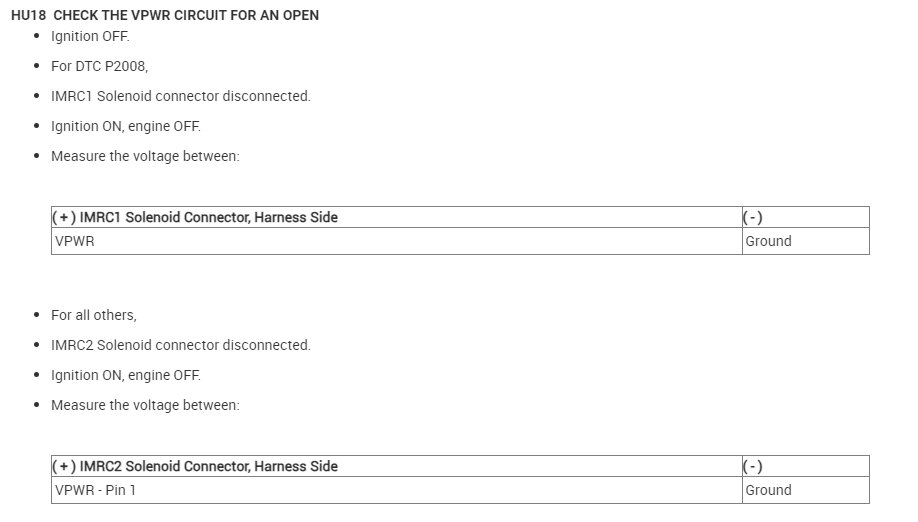

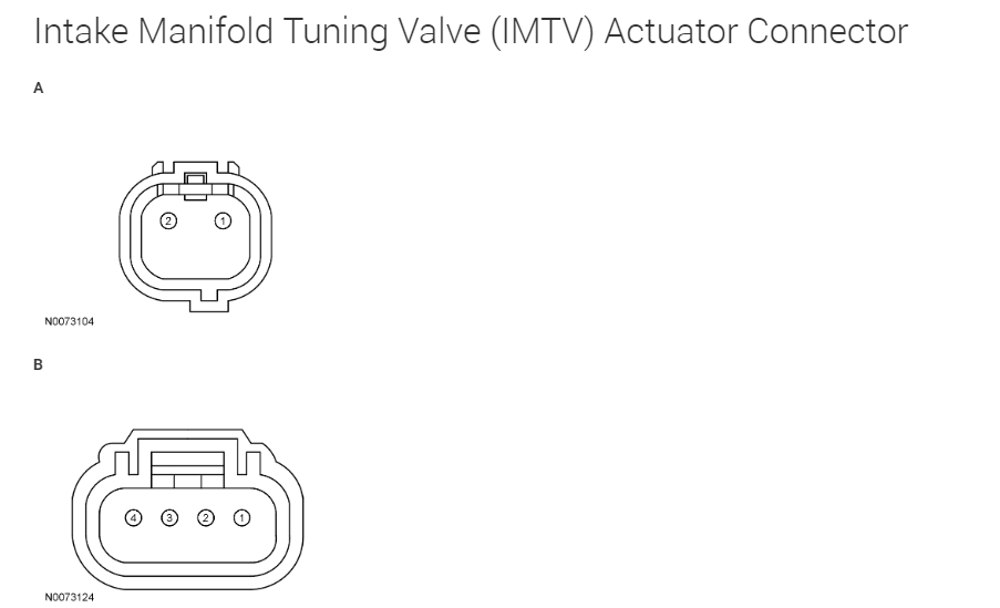

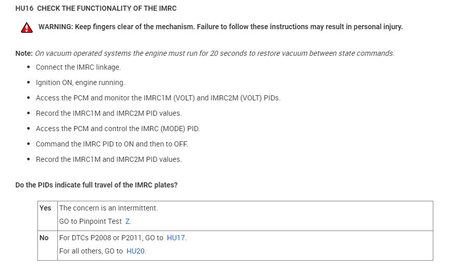

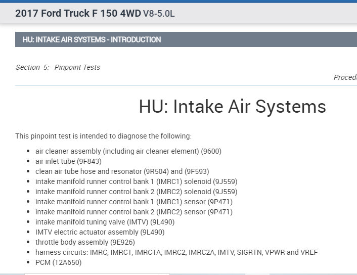

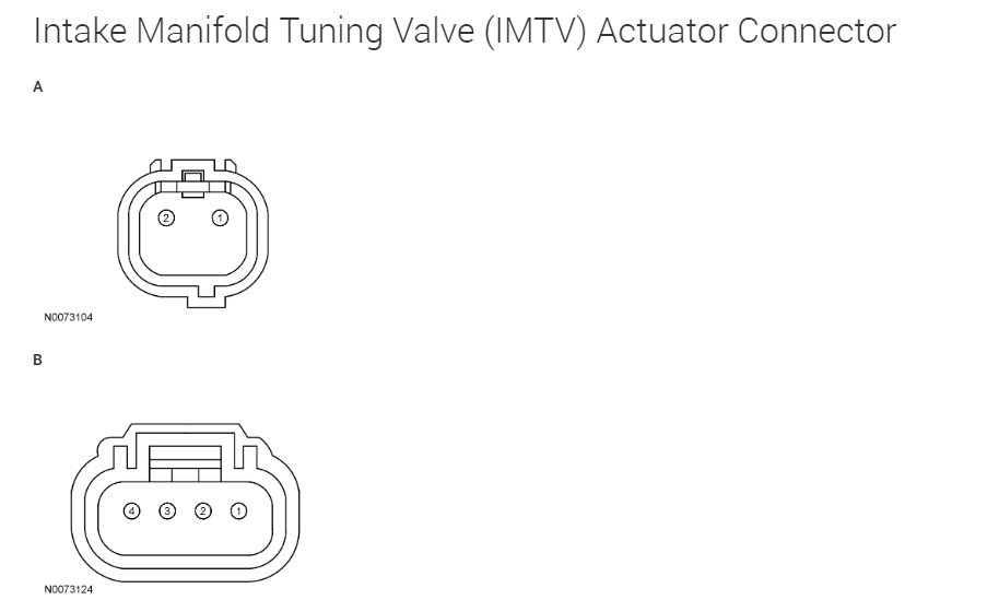

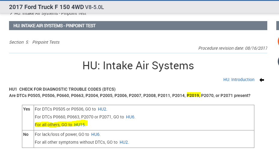

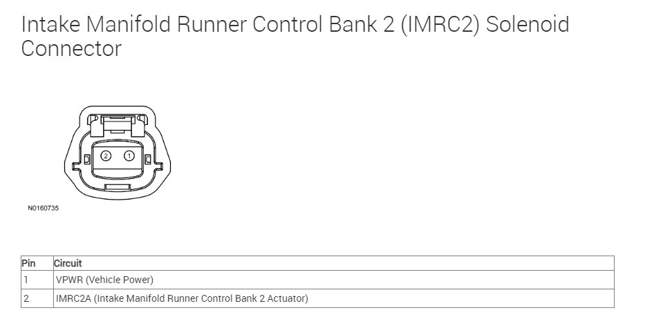

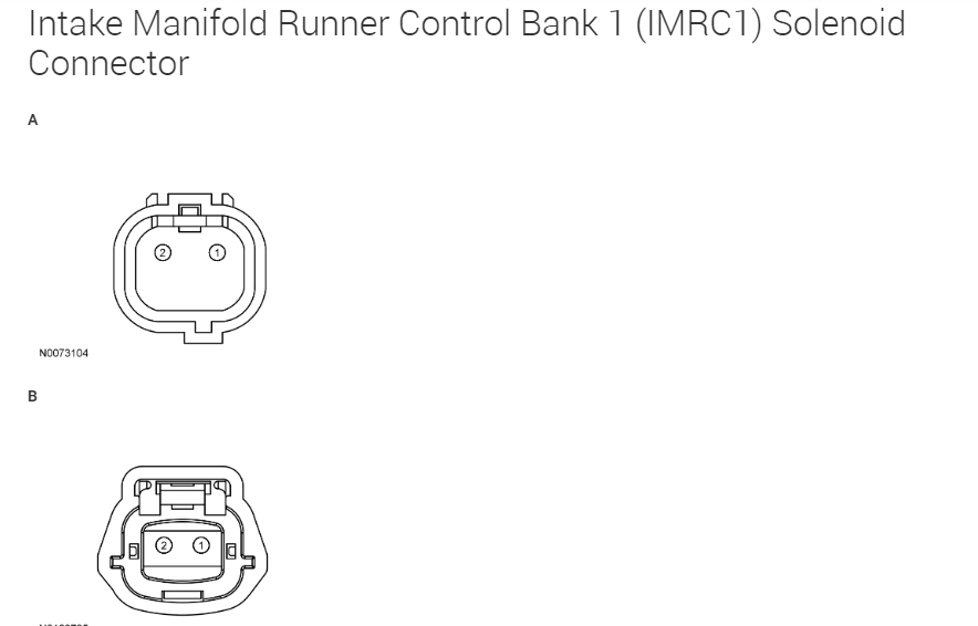

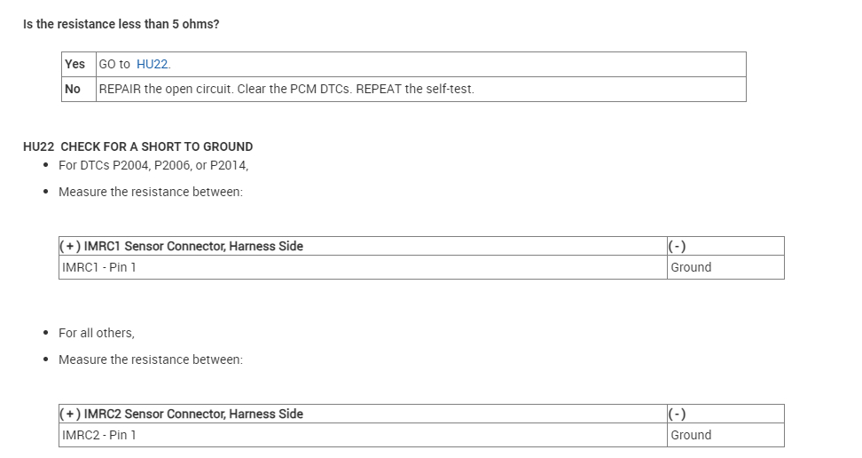

The P2019 is related to the intake manifold runner switch, bank 2. If it isn't working properly, you will experience engine issues. Also, the EVAP code is related to excessive fuel tank vacuum. At this point, my theory is the issue with the runners may be causing the additional code.
If you look below, I attached the diagnostics for the P2019 code. I skipped the portions related to bank 1 because of the extent of the tests. Take a look through them and let me know if you are comfortable performing them.
