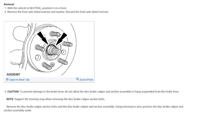

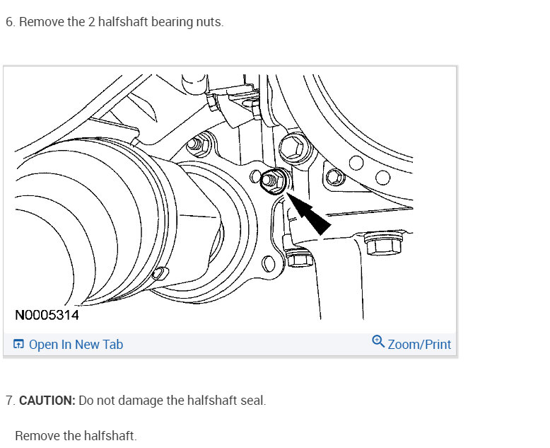

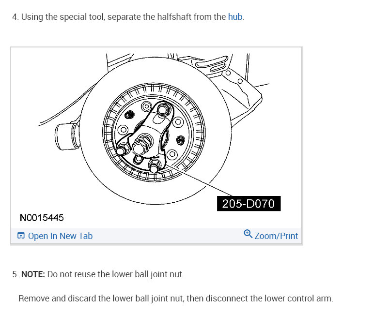

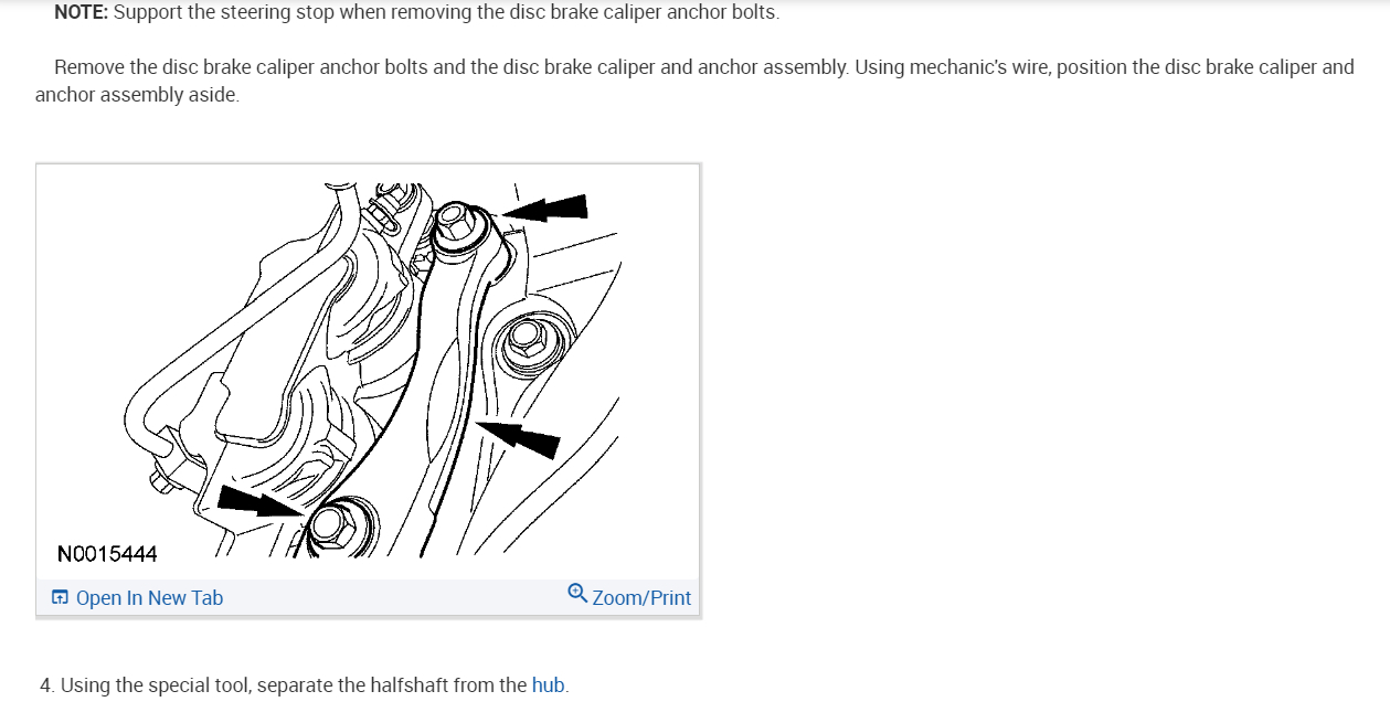

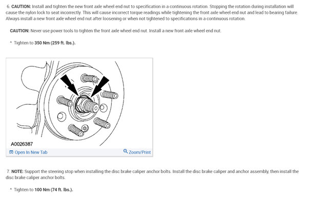

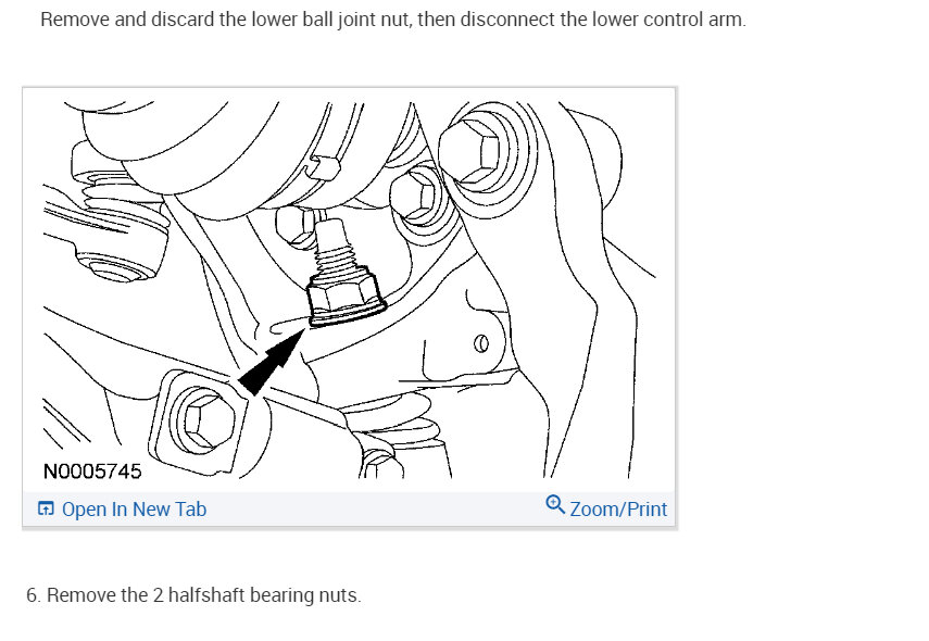

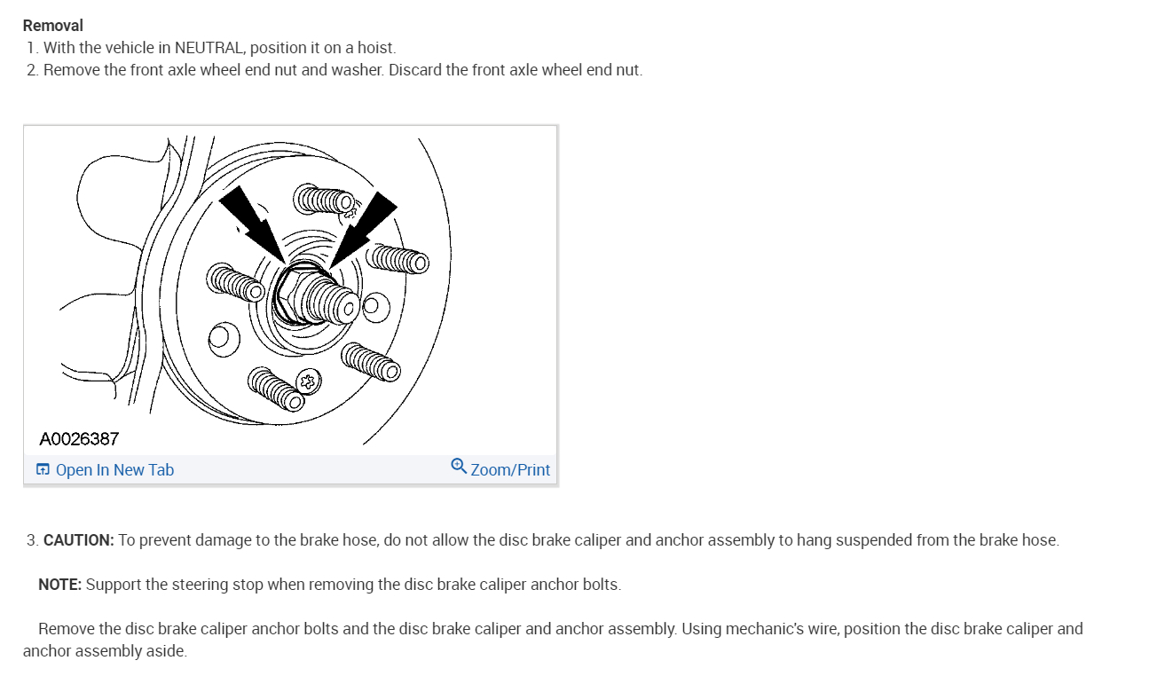

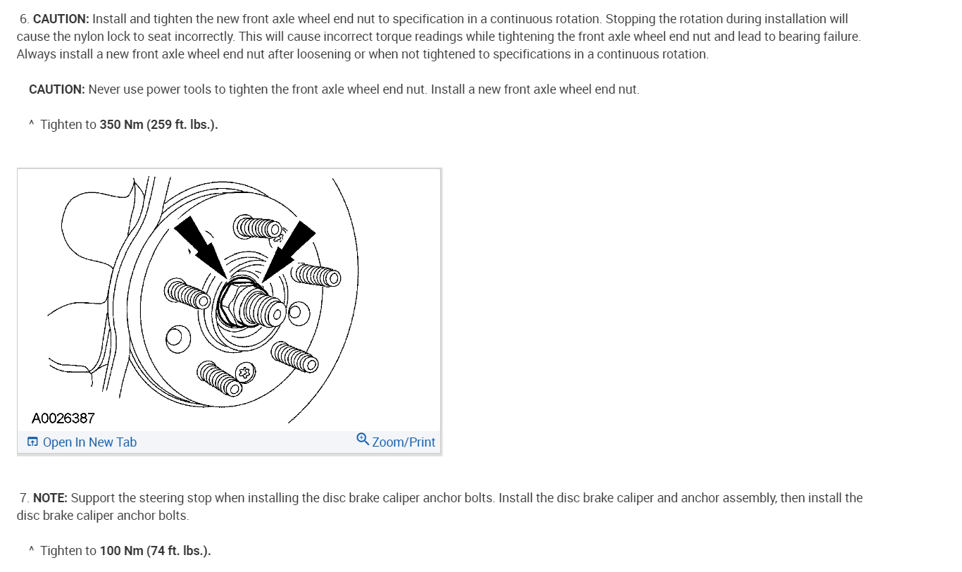

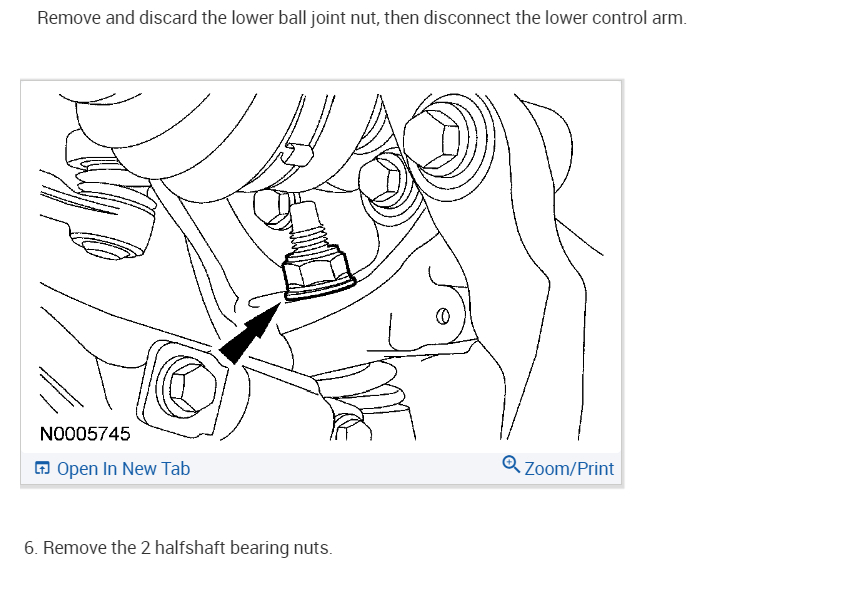

Need some advice, I have a 2.0tdci estate. When accelerating moderately or heavily the car shakes violently, doesn’t shake if pressing the clutch and rolling from accelerating, well start again once depressed and accelerating again. The steering wheel doesn’t shake, just the whole car. Under light acceleration it doesn’t shake at all. Any suggestions please?
Oct 3, 2022 at 11:12 PM
  • 55,412 POSTS

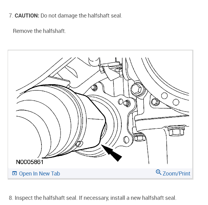

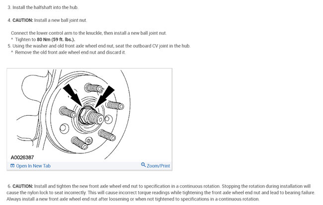

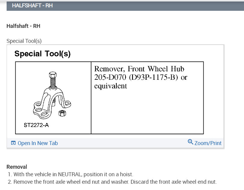

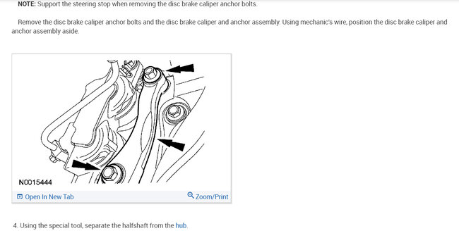

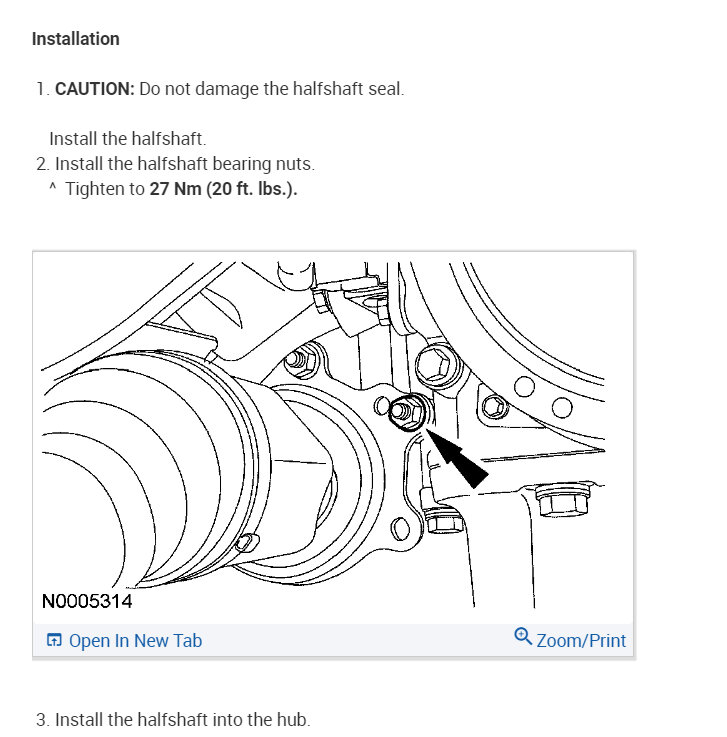

Let's try this again, it sounds like you have bad CV axles which can cause this issue. Here is how you can change them out in this generic guide to help walk you through the steps and check out the images below on how to change them out on your car.
https://www.2carpros.com/articles/replace-cv-axle
