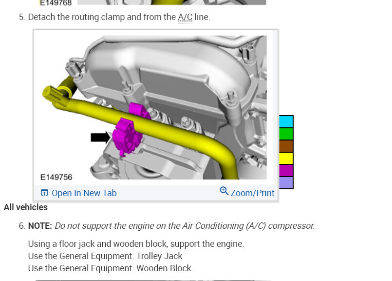

I'm not sure if this is normal or if there are any common issues with these. once its warm and idle is down it is much better. car drives excellent. Any common problem with these that ring a bell?
Oct 28, 2022 at 8:33 AM
  • 55,845 POSTS

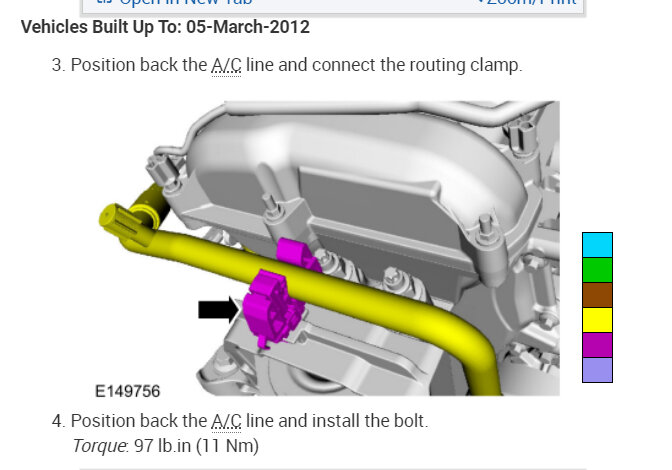

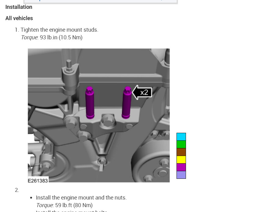

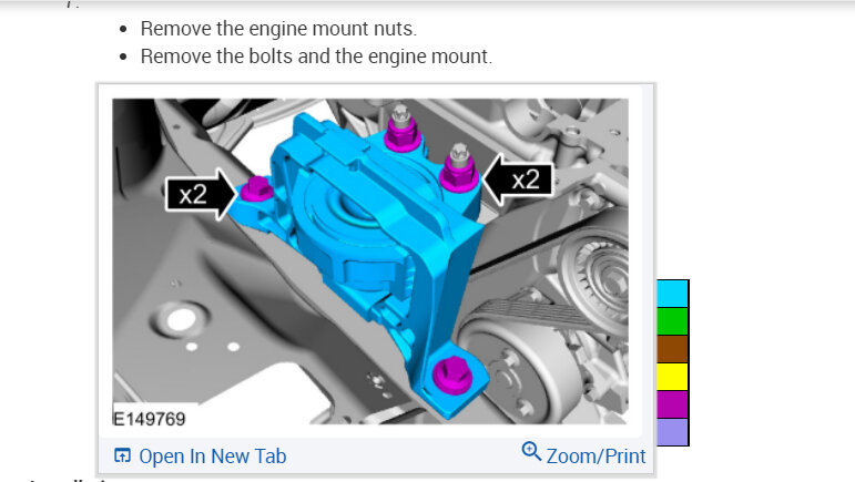

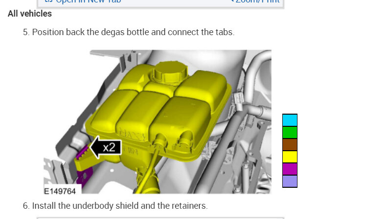

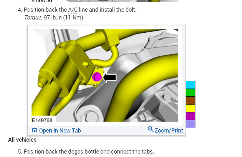

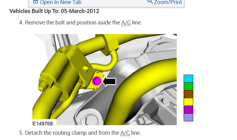

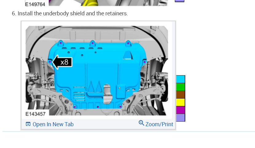

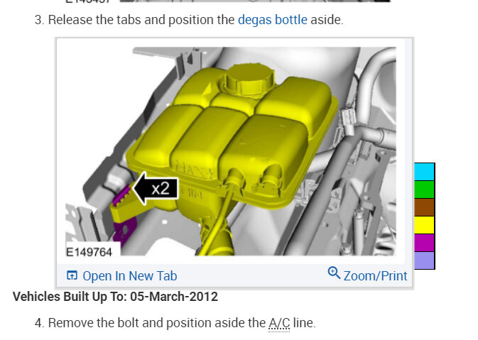

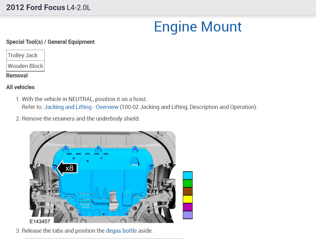

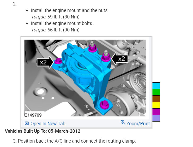

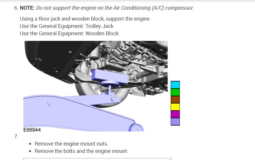

This happens when the engine mounts need to be replaced. Use a flashlight to see if the rubber is dilapidated, here is how to replace the mounts in the images below. Check out the images (below). Let us know what happens and please upload pictures or videos of the problem.
