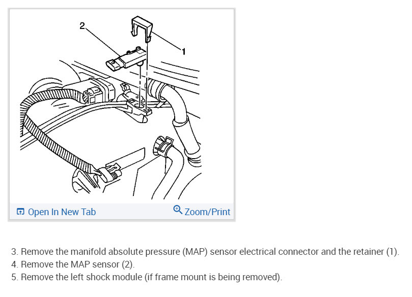

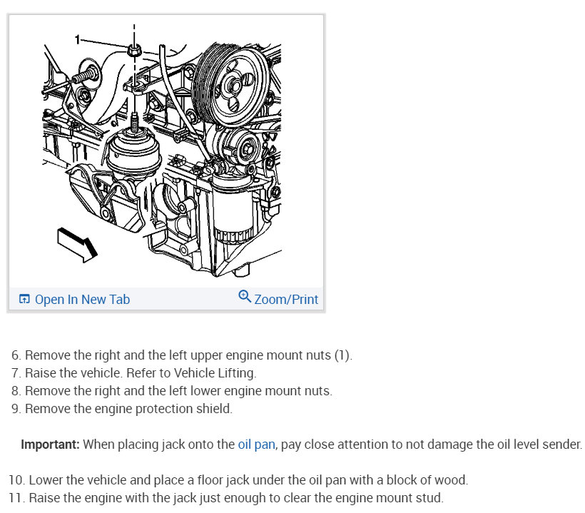

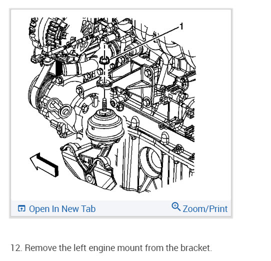

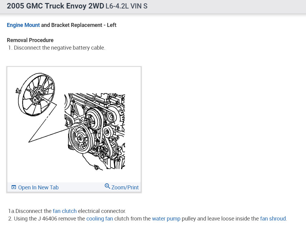

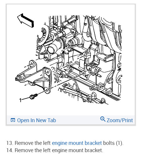

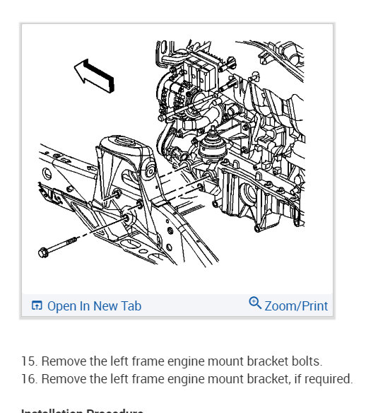

Yep, engine mounts are my opinion here especially with that kind of mileage. Here are diagrams to help you replace the them below.
