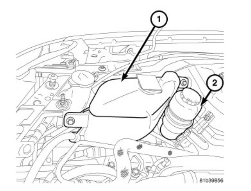

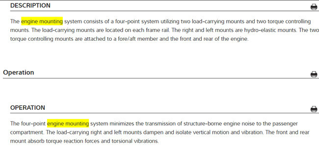

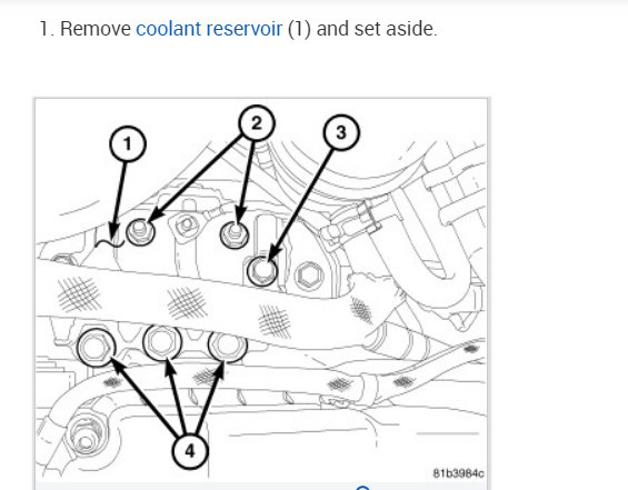

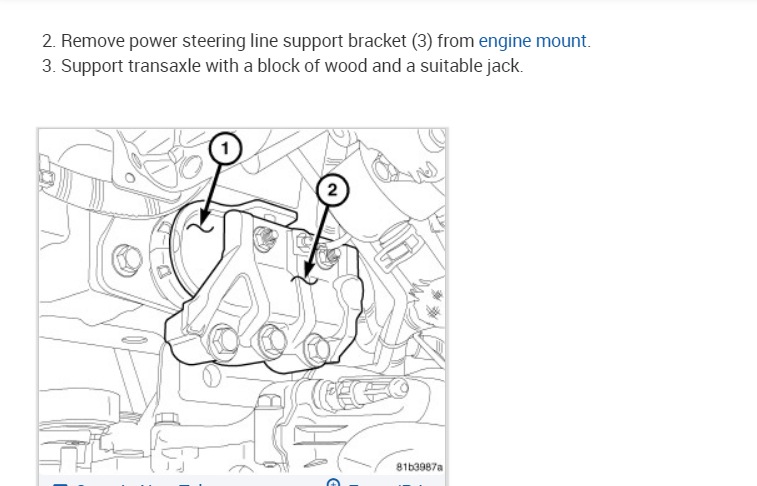

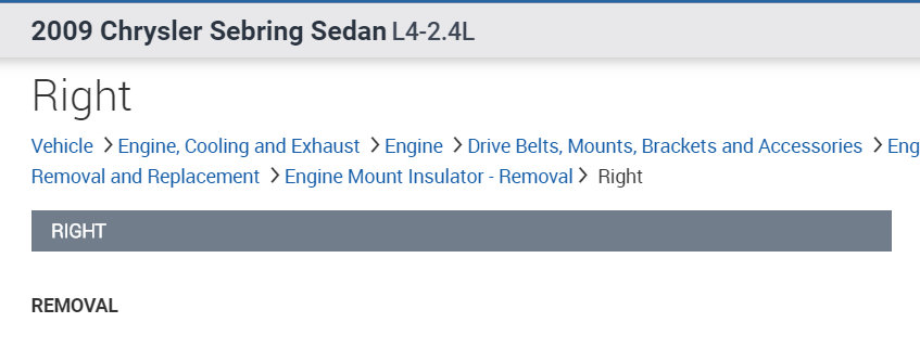

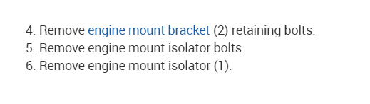

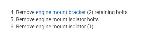

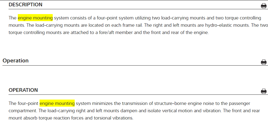

This is probably going to be either broken motor mounts or broken transmission mounts, or both. In the diagrams down below I have included a description of how the motor mounts on your vehicle work, and instructions for the removal of the right hand side motor mount. Installation is the opposite of the removal. If after you need instructions for the removal and installation of the left, front, or back motor mounts, please let us know and we can get those out to you, either way, please let us know how things turn out.
Thanks,
Alex
