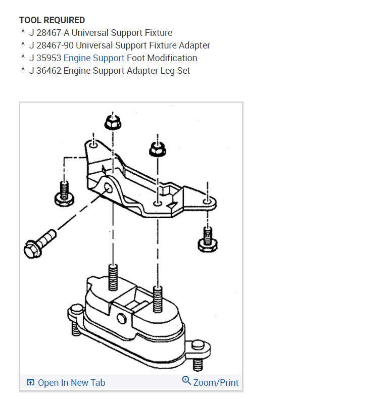

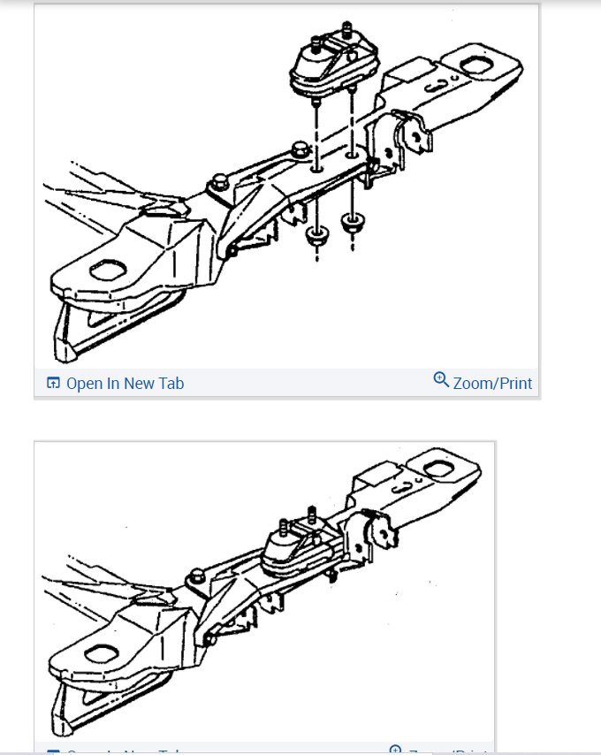

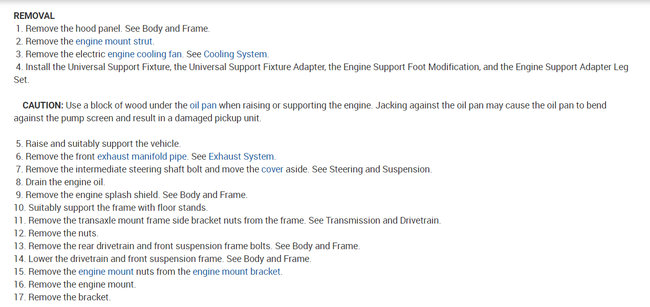

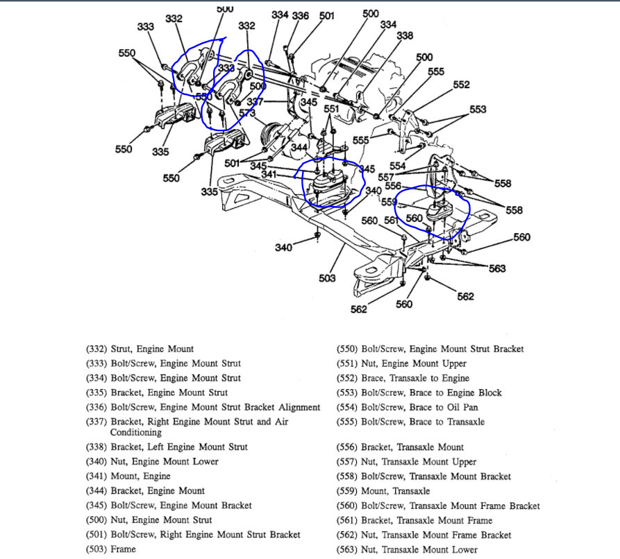

There are a total of 4 mounts for the powertrain. I posted the mounts below for your review.
https://www.2carpros.com/articles/how-a-motor-mount-works
https://www.2carpros.com/articles/replace-motor-mounts

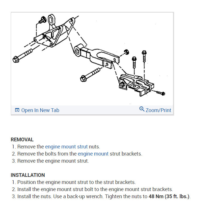

Which mount did they replace? The upper engine struts were the most common failures for the big movement of the engine while running.
https://www.2carpros.com/articles/vibration-noise
Are you sure it is a mount issue and not the engine running rough making you think it is a mount?

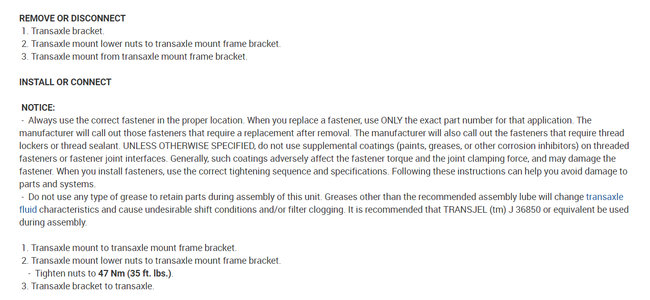

The other mounts I listed need to be checked for being broken or worn out.
