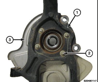

I just bought a 2016 Dodge Charger SXT AWD and I hear a vibration coming from the front right randomly. No specific speed, turning, not turning. I don’t feel it but I hear it almost like I’m driving on rumble strips. To add info, on my way home from work I noticed if I lightly tap the gas and then tap the brake right after it does it for a split second each time. Any tips?

Yep, this is most certainly the wheel bearing hub on the right front which will cause the problems are are describing both with the noise and the ABS system coming on. Here is the the part that needs to be changed. Check out the images (below). Please let us know what happens. Ken
