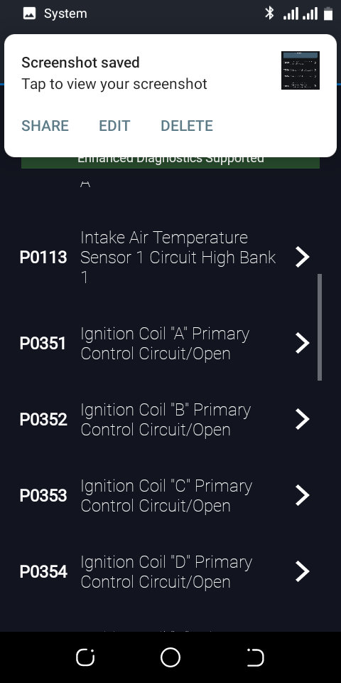

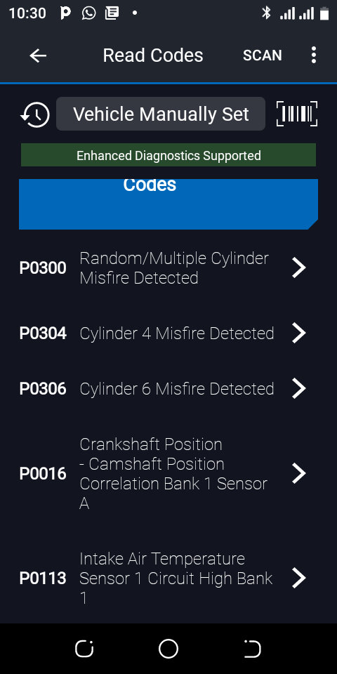

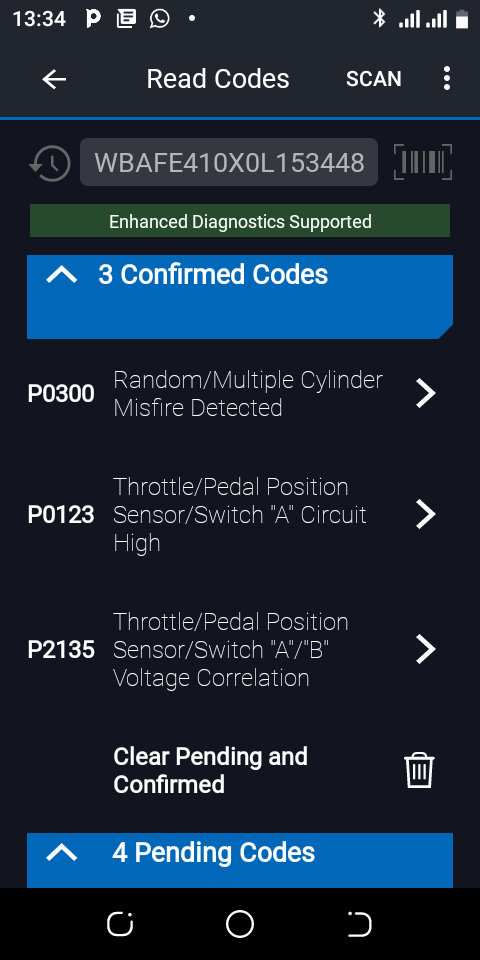

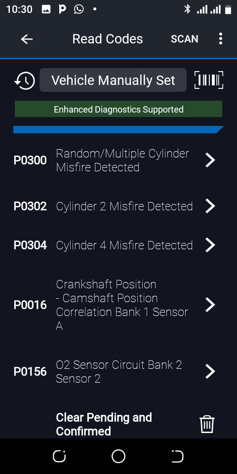

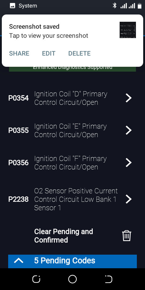

I scanned the car and retrieved some codes that I will upload. Among those codes, I was particularly focused on the P0016, P0113, P0123, and P2135 although I verified the ignition codes and saw that it fired very fine.

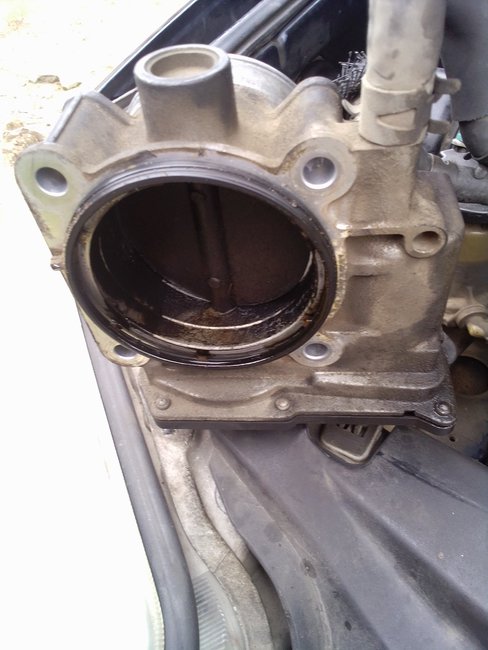

As a result, I cleaned the CMP sensor of the 2 banks and installed them back but to no prevail, I still noticed a vibration. I pulled the CMP sensor again within 2 minutes of idling and noticed that it was dirty again. This time I had to pull VVTI solenoid valve of both banks alongside the CMP sensor and cleaned them. In addition, I used a very clean dry cloth and insert into the CMP sensor hole to properly clean the inside of the engine. In the process, I also noticed that the injection head where the TPS sensor is tightened was very dirty as when a carbon and oil are mixed together so I cleaned that too using a tooth brush.

However, there is a problem that I want you to help me out with. It's a high rev in RPM to about 1.4 at idle. I Before I left there yesterday I scanned the car again and found only the P0123 and P2135. Please note that this two codes appeared only after cleaning the CMP sensor, VVT solenoid valve and the injection head. It didn't appear before the cleaning of those accessories.

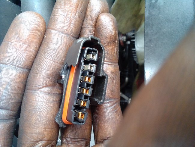

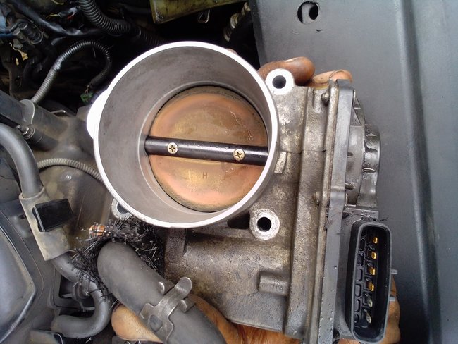

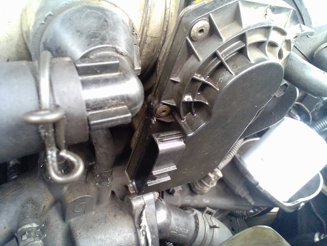

When I started the car, it revved high from about 1.25 to 1.4 RPM and remained there. The RPM doesn't go up and down. When I accelerated the car, it rev very fine. I also noticed that the TPS connector was slightly broken, it didn't fit in very well and didn't hear a snap sound when connected to the TPS module. But whenever I pulled the TPS connector completely out when the car was idling there was a great reduction in RPM as if the car wants to stall so I immediately connect it back slightly and noticed that the RPM goes down and remains at 1,000 RPMs. The car owner even noticed the reduction in RPM, stood up and moved to me and said that that's the way the car should idle. But if is still connected at that place and switch off the car it idles to 1.4 RPM and remains there until I repeat the unplugging of the TPS connector process.
I tested the connector with my test light and noticed 2 ground out of the 6pins (one of the ground was very dim the other was bright) at the pin connector that illuminated the dim light when tester was at battery positive. I also noticed a dim light when I checked for current with my test light now hooked up to ground and ignition switch activated to "on" position.

So, is the engine quiet now when full of oil? Can you please shoot a quick video with your phone so I can hear the noise? That way I can tell for sure what's going on. You can upload it here with your response. If the timing chain guide is broken that will cause these issues. Please clear the codes and then without starting the engine leave the key on and run the codes, this should give us the hard codes we need to fix. It does sound like the TPS sensor is bad or the connector is broken and not connecting so please look at that as well. Here is how to change out the TPS sensor which is inside the throttle bore in the diagrams below. Check out the diagrams (below). Let us know what happens and please upload pictures or videos of the problem.

Presently the condition for the TPS connector is worse than this.

I sprayed carburetor cleaner to the TPS sensor and butterfly of the throttle body again. I wiggled it back and forth severally. I also tapped on the TPS sensor when the car was idling.
I loosened the car negative battery terminal and waited few minutes and then connected it back. I also unplugged the TPS connector then cranked the car twice knowing it wouldn't start and idle. I connected the connector back.
I cleared the codes and cranked the engine everything was okay again with God's support!
