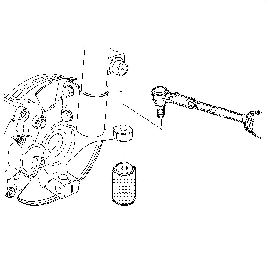

Hi, i am having problems with my front end when i turn the wheel all the way to left and right the whole front end vibrates.

Is there any noise associated with the vibration? If there is a clicking noise, it sounds like there is an issue with a CV joint. Take a look through this link. It describes symptoms related to a bad CV joint. See if it seems to mirror what you are experiencing. The first link explains a CV joint, the second symptoms and the third in general replacement.

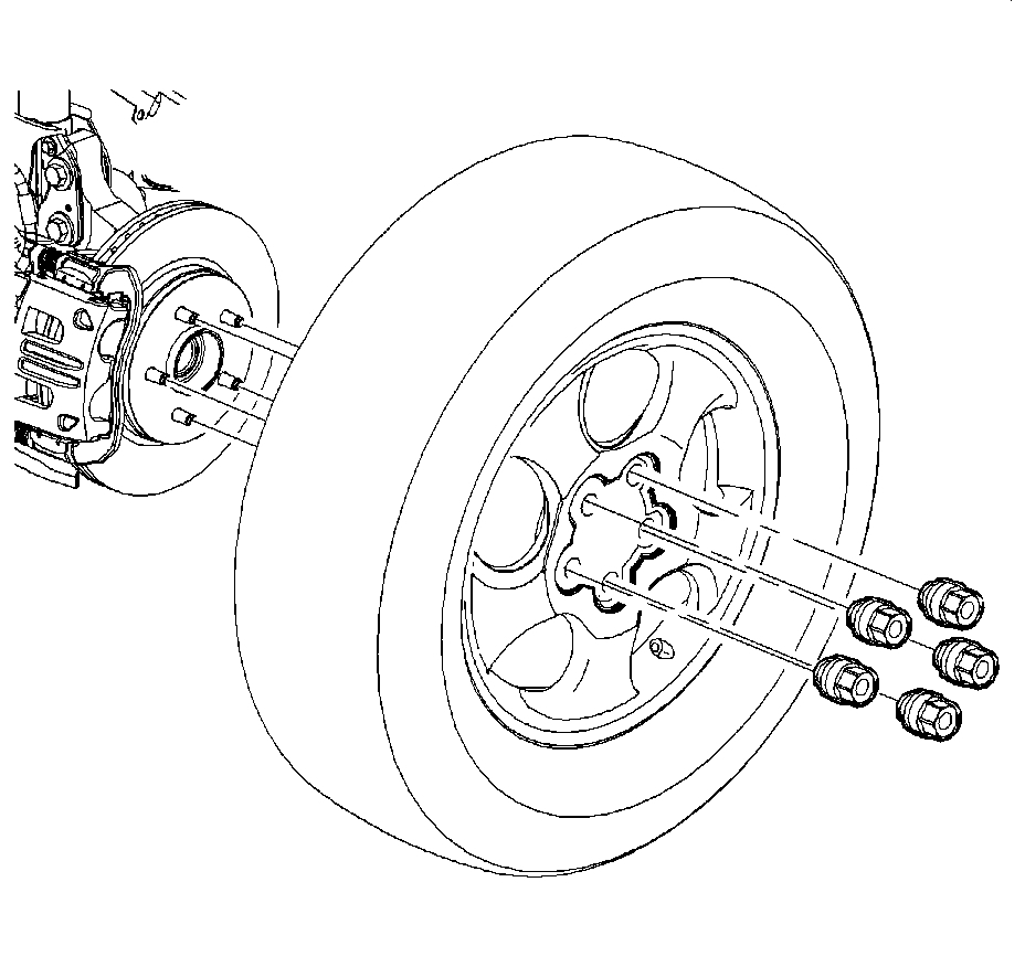

pic 1
1. Raise and support the vehicle. Refer to Vehicle Lifting.
2. Remove the tire and wheel assembly.
3. Remove and discard the wheel drive shaft spindle nut.

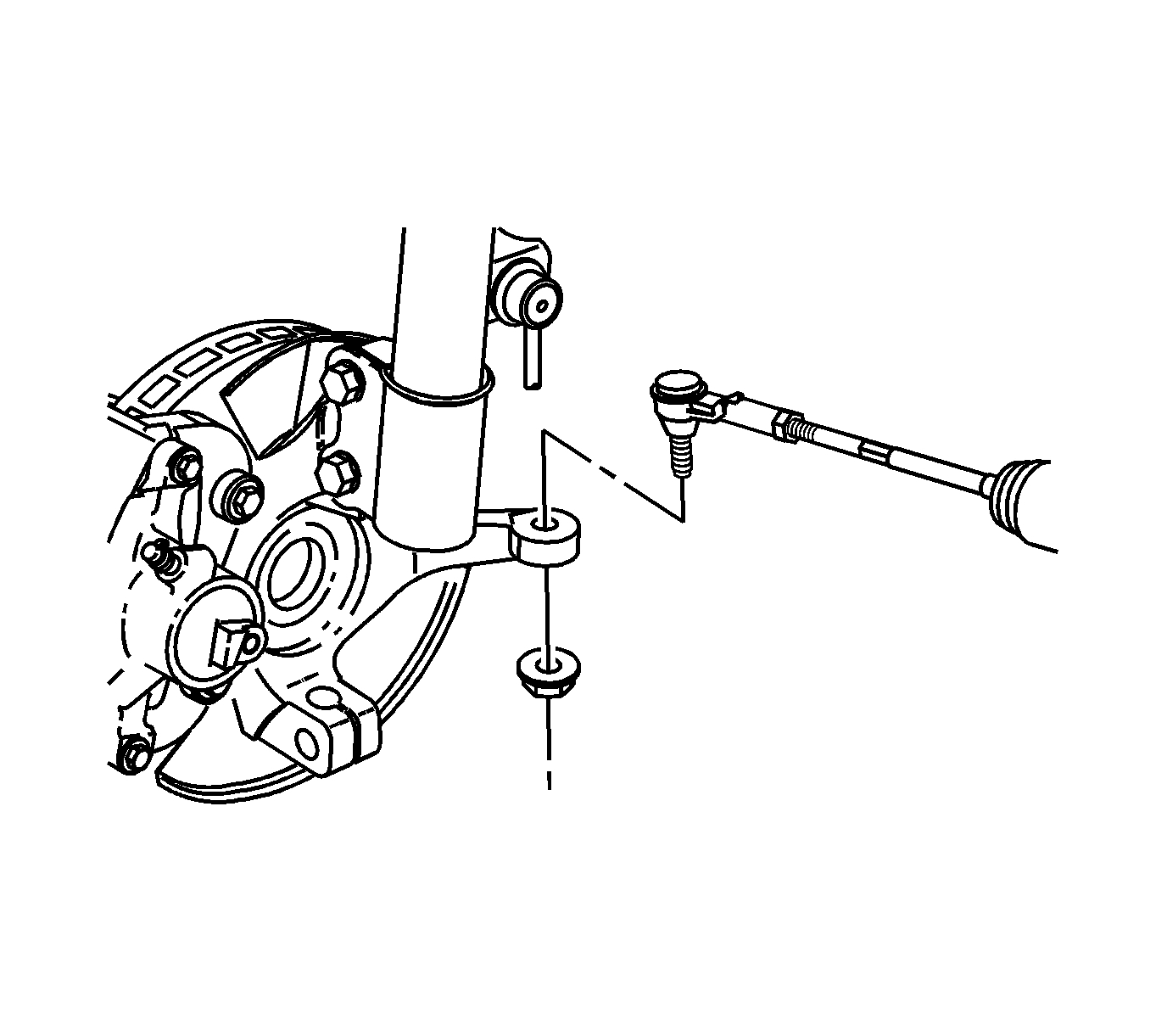

4. Notice: Hold the ball stud from turning when removing/installing the nut. The boot can become torn and damaged if the ball stud turns.
Remove the outer tie rod end-to-steering knuckle nut. Do not loosen the tie rod end jam nut.

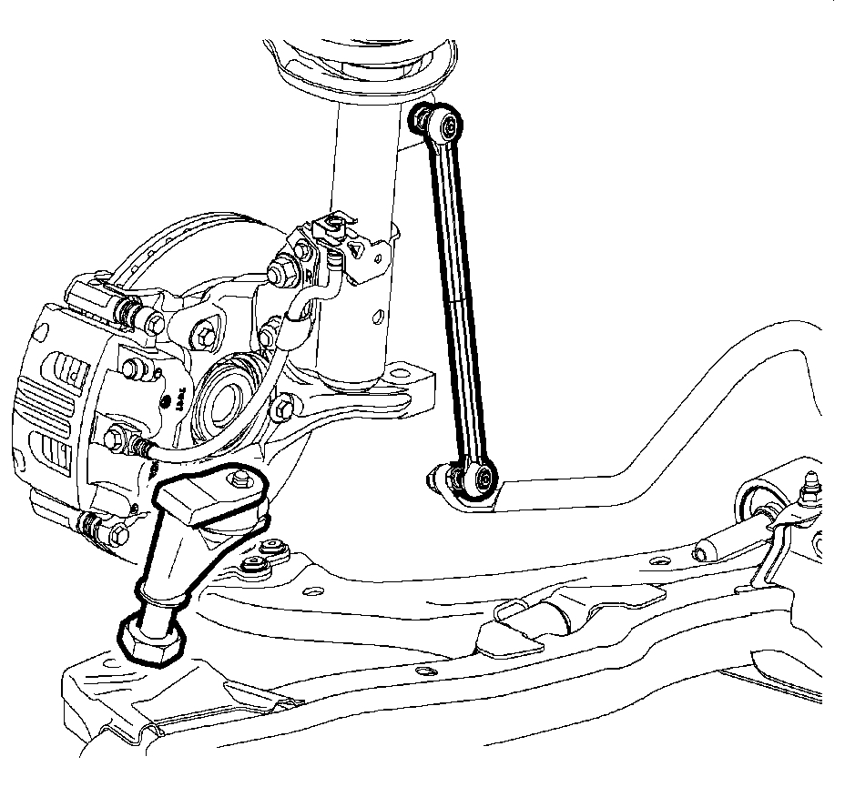

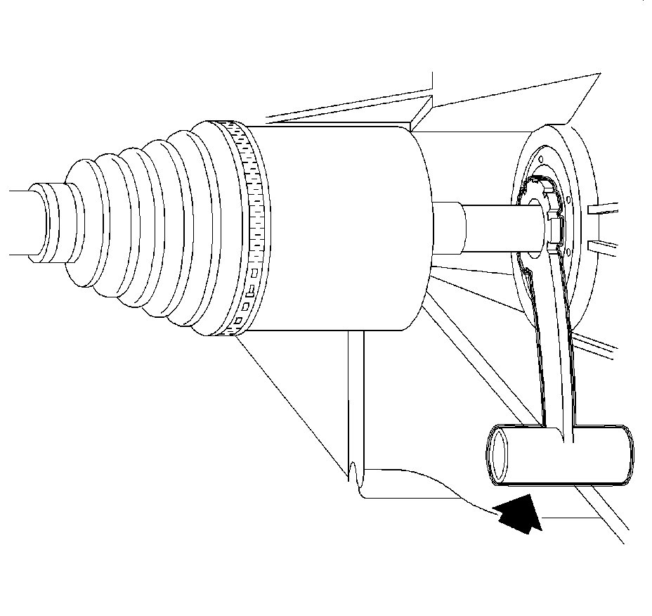

pic 2
5. Important: Do not use a wedge type tool to separate the tie rod end from the steering knuckle.
Using the J 24319-B separate the tie rod end from the steering knuckle.

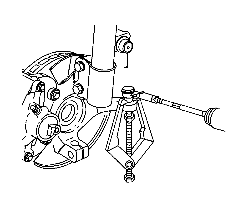

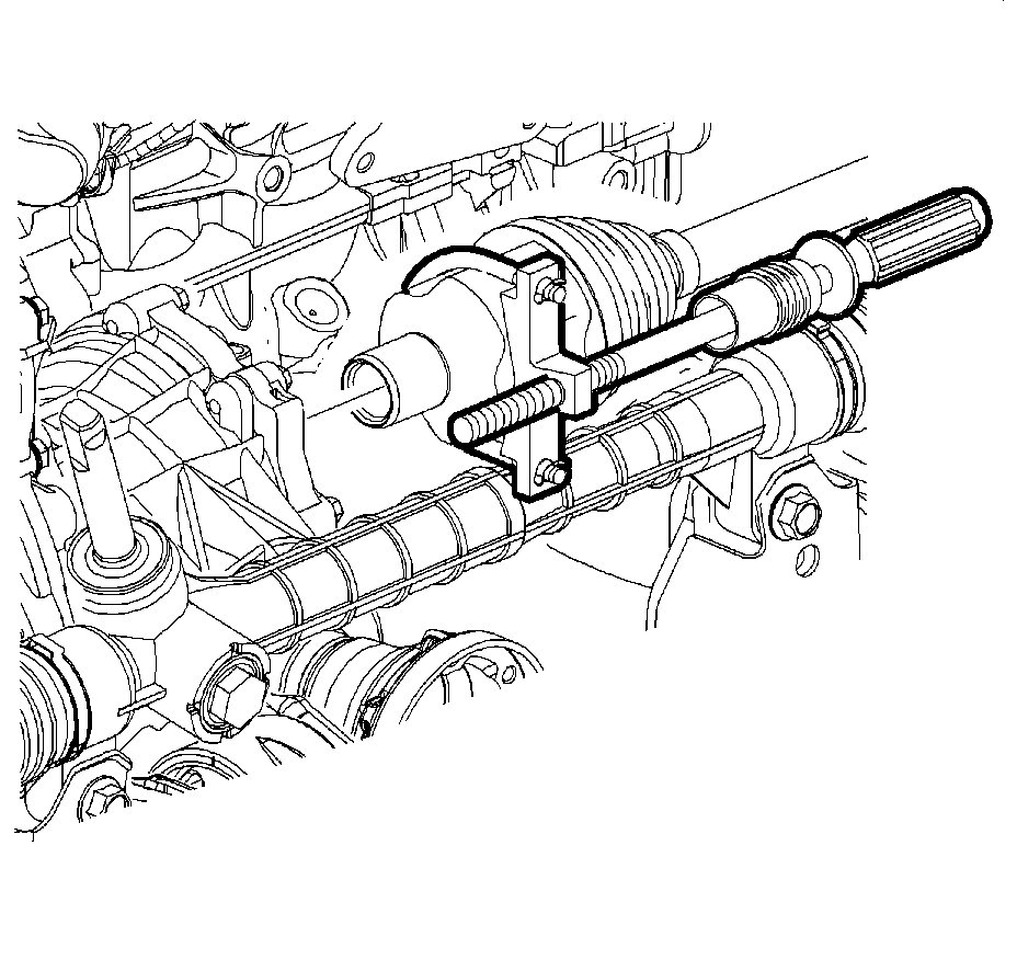

pic 3
6. Remove and discard the cotter pin from the lower ball joint stud.
7. Remove the ball joint stud nut.

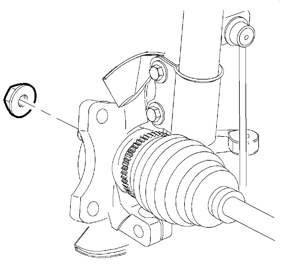

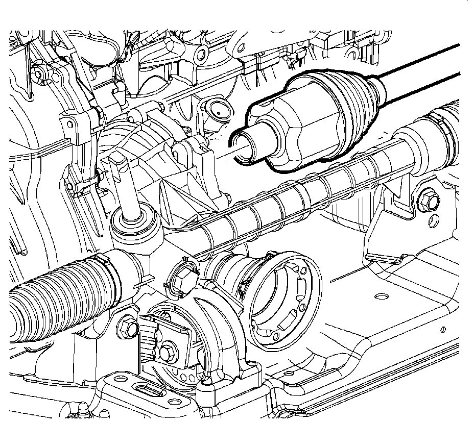

pic 4
8. Using the J 43828 separate the lower ball joint stud from the steering knuckle.

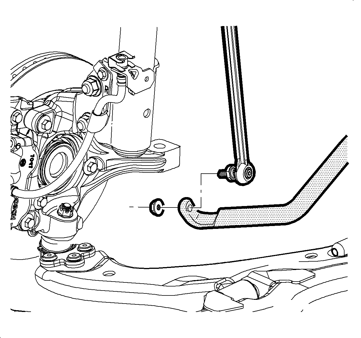

pic 5

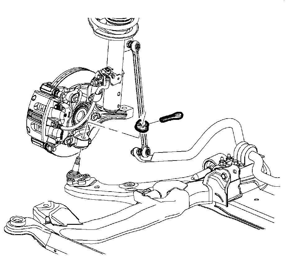

9. Using a backup wrench on the stud, remove the nut securing the lower stabilizer bar link and disengage the link.
10. Disengage the wheel drive shaft spindle from the wheel hub assembly. If necessary, place a wood block against the end of the wheel drive shaft spindle and tap with a hammer to aid removal.

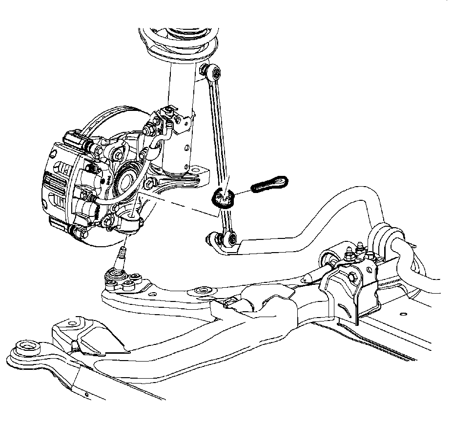

pic 6
11. Important: Use care not to damage the joint seal when removing the wheel drive shaft.
Assemble the J 45341 and the J 2619-01 to the wheel drive shaft inner tripot joint.
12. Important: On vehicles equipped with all-wheel drive (AWD), the stub shaft may disengage from the power takeoff unit (PTU). If necessary, cap the opening in the PTU to prevent fluid loss.
Disengage the wheel drive shaft from the transmission or power takeoff unit (PTU), if equipped.
13. Remove the wheel drive shaft from the vehicle.

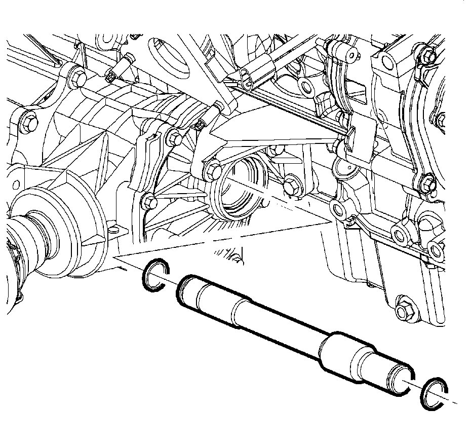

pic 7
1. Install a new wheel drive shaft retaining ring to the output shaft.
pic 8
2. Install the J 44394 to the wheel drive shaft oil seal.
pic 9
3. Install the wheel drive shaft to the output shaft:
^ Guide the wheel drive shaft tripot joint squarely onto the output shaft.
^ After the splined end of the wheel drive shaft passes the oil seal, remove the J 44394 from the oil seal.
^ Firmly engage the wheel drive shaft to the output shaft.
^ Ensure that the tripot joint is fully seated on the output shaft by grasping the tripot joint and attempting to pull free of the output shaft.

15. Install the tie rod end to the steering knuckle.
16. Using the J 44015 , pull the stud into steering knuckle.
^ Tighten the J 44015 to 40 Nm (30 ft. lbs.).
17. Remove the J 44015 from the tie rod end stud.
pic 14
18. Install a new nut to the tie rod end stud.
^ Tighten the nut to 50 Nm (37 ft. lbs.).
