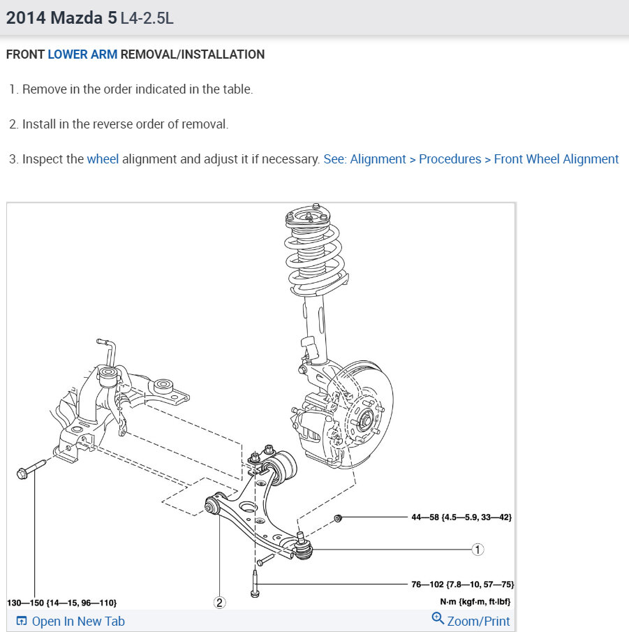

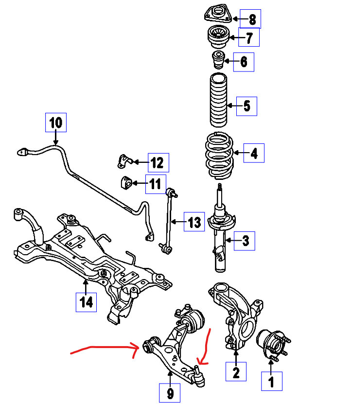

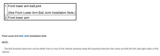

Typical it is wheel balance that will make the steering wheel wobble at freeway speeds, but I have seen the lower control arm bushing or lower ball joints cause this problem as well. I would have the tires balanced and if that doesn't fix it let check the front end.
