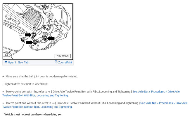

Suspension issues haunt me every time i buy a car. This one has new wheels and tires. At 40-75 shaking increases, i didn't drive it past that. I balanced all wheels and they only needed minor adjustments. One of the rear tires was flat when i bought it. So, it may have been sitting flat for a while not sure. I tried to find a flat spot but i couldn't see any. I put gear in drive for the fronts to see about axles and videos are shows. No grease from any of the boots, suspension is solid, 100% tight, zero vibration in steering when you hit the brakes, all brakes have plenty left. No clicking or clunking from anywhere, just mainly vibration in cabin and floor. First three clips for driver side, last two for passenger. Both wheels/tires jump a bit but i think this is normal. No play in axles other than the normal play u see in any axle. No up and downplay.

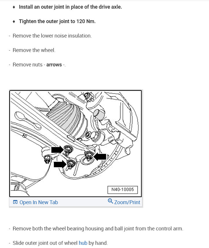

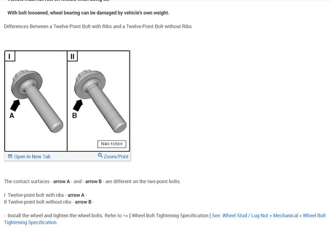

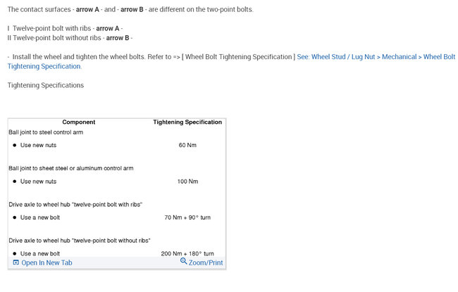

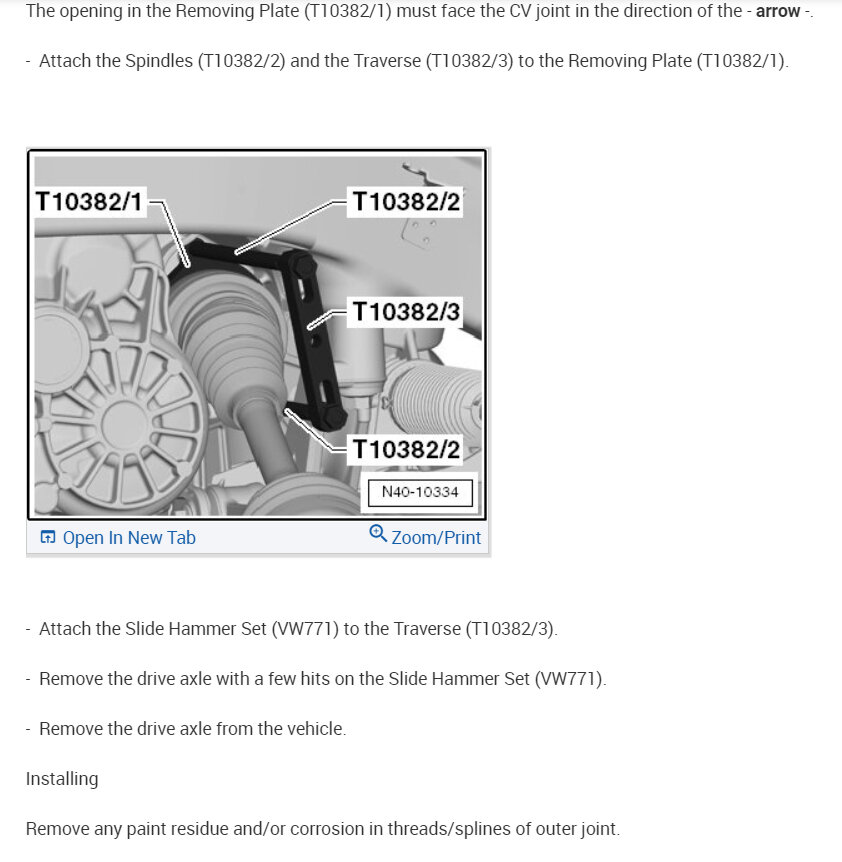

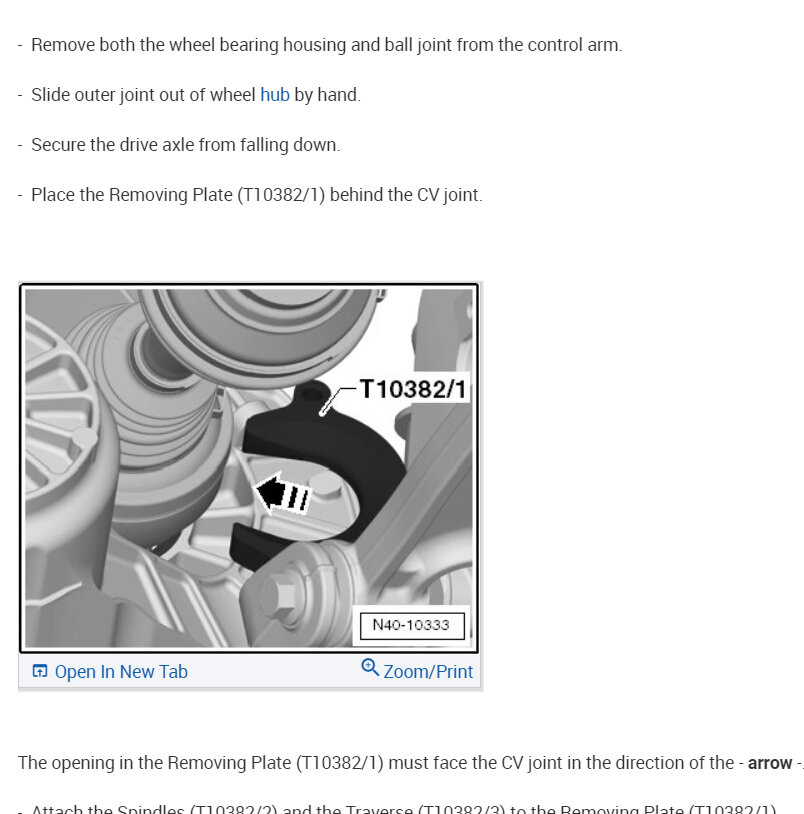

Not that i see, just aftermarket wheels, some intake stuff, nothing that would cause vibration. Am going to change both axles.
Sep 8, 2023 at 8:27 AM

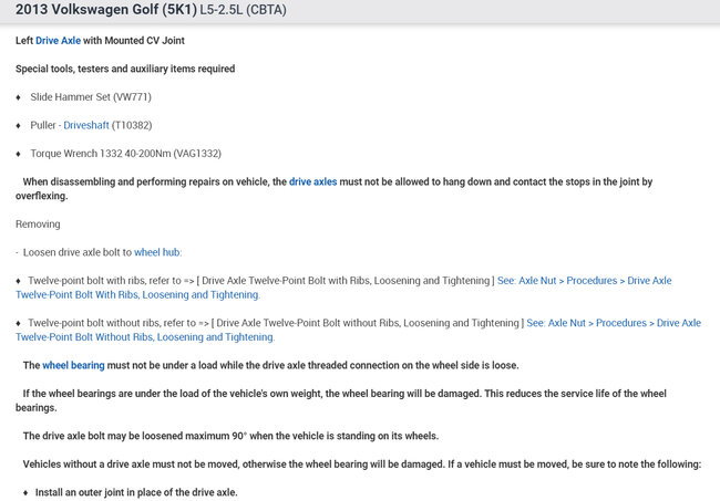

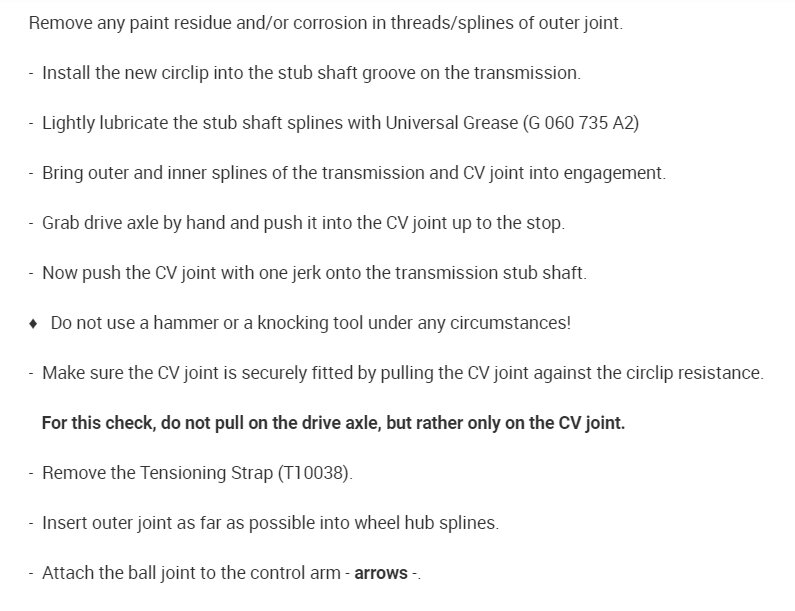

  • 55,694 POSTS
Good call, here is how the job is done. Check out the images (below). Please let us know how it goes.

  • 2,007 POSTS
After trying several rings to find the right one, vibration has gotten much better. Now it will shake in the steering around 65 mph-70 and then I think goes away.
