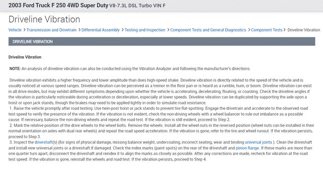

It's smooth before 40MPH and after 55MPH. Tried replacing all of the following. Ball joints, tie rods, sway bar links, wheel bearings, shocks, stabilizer shock, u-joints twice, tires mounted and balanced, fresh alignment. Has a slight sway as well after new tires were installed? It doesn't have a lift kit. Also tried rotating drive shaft 180* with no change. Accelerating, braking, coasting doesn't change vibration even when shifted to neutral while coasting.

Does this have a one or two-piece rear driveshaft? Where do you notice the vibration the worst, in the floor/seat or in the steering?

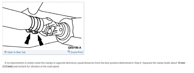

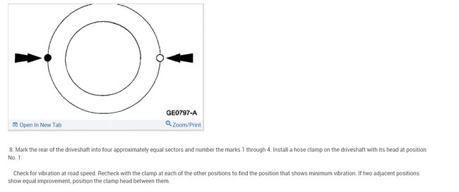

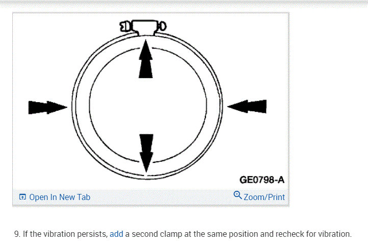

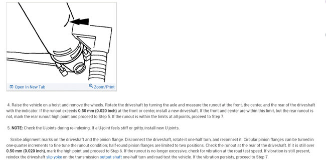

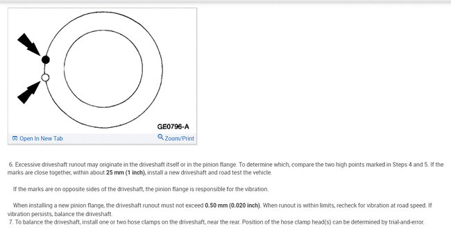

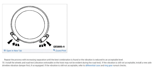

If possible, take a look through the attachments below They review what to check for a vibration specific to this vehicle. Let me know if it helps.

It's a one-piece driveshaft. After inspection I found another u joint was shot. Third set in less than 1,500 miles. I switched from the Moog brand to Spicer brand with hopes they are better. Could the driveshaft be causing u joints to be going out?
Apr 20, 2022 at 9:22 PM
  • 110,244 POSTS
A driveshaft can cause this to happen if it is bent or out of balance. Does the vibration go away after the joint is replaced?
